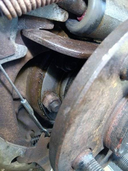

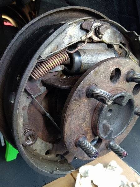

Backed out the car this am and took both of the rear drums off to better adjust the brakes to see if that would get rid of the break system warning light being on.
When I took the passenger side tire off l saw a wet oily spill on it. When I took the drum off there was break fluid all splashed all over, mystery solved, the piston is dripping brake fluid.
That side was really dirty when I took everything apart the other day. Looks like it had been dripping at some point and scabbed over. Spraying brake cleaner all over and brushing everything clean took the scab off.

That’ll do it. Great catch
