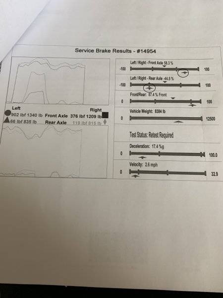

I was thinking the scale went from -100 to +100 left to right. When my right front was “too far right” I thought too tight, so I loosened it up some, which didn’t work.
I learned that on the scale, left front is calculated from -100 right to the center and right front is from 100 left to the center. So I need to tighten the right from more to bring the arrow left towards the center.
So: They'll be a pass for a week anyway until they wear a touch and go out of adjustment, sheesh.

Anyone familiar with a Hunter B - 400T Plate Brake Testing Machine? Delaware DMV uses this to test braking? My '68 Super Bee failed and I want to confirm what I need to do.
See the attached picture. On Left/right Front, the bottom arrow failed (right front I assume?) Does that mean it's too much brake pressure? Looking at the graph, the left states 1420 lbs and the right 1209 lbs. Not sure how to interpret that.
Same for the Left/right rear. Right rear not enough braking pressure?
I guess the first question is: is the top arrow right or left side of the car?? The guy in the lanes had no idea how to explain it to me.
This car is 4 wheel drums, no power. DMV is a 30 minute drive each time and I want to set the brakes properly before I go and fail the test again.

I am just seeing this. It has been many years since I did any testing on the B400 brake test plates. I do know worn shocks and unequal tire pressure could cause failure. I think if the would have this printout it would have made more sense.
