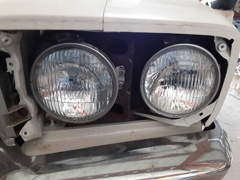

Found it.
Guess I pinched the harness under the pass side light bucket.
That does NOT sound like something I would do, but have no one to argue with bu myself.
Cleaned it up and put it back together.
