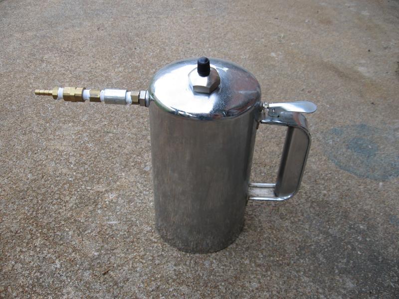

It should be noted I’ve never been accused of doing anything fast, simple, or easy…...I have a knack for doing things the hard way. Sooo, I rigged up this sure shot sprayer so I could flush with isopropyl alcohol before switching to silicone fluid. I was doing a brake job anyway so all the lines were disconnected and I was only flushing the lines. You might be able to do something similar using fresh fluid in the sure shot. It would require disconnecting the brake lines at the master cylinder.

That seems to be an usable tool ! , but forgive me, I'm not familiar with the word "sure shot sprayer",have no Swedish word for it. What is it normaly used for ?
Thanks, Lasse
You pressure it up with air from a compressor etc and you can shoot bulk chemicals with it.
I just checked the Sure Shot website but didn't see a "where to buy" section. There's bound to be something similar there. They are commonly used in machine shops for spraying rust inhibitors and solvents.
