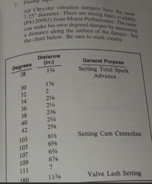

How would I know where 36° is at on the balancer?
I do believe it's approximately 1/16" per ° for a 7-1/4" diameter balancer.
MP ........
My degree wheel, is about the same size as the crank pulley. So marking the pulley is fairly easy, and degree wheels are fairly cheap.
