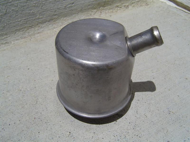

Just curious, i am cleaning out my breather cap for my 340, because i can only find chrome replacements, and i dont want chrome.
So, is there anythig besides the metal baffel inside the cap? Just want to make sure that once its clean, i can repaint it and use it. Anyone know if there is any filter material in there?
Here is what it looks like.

Yes there is a "filter type media inside. It resembles a course steel wool. I bought one and got ready to paint it and upon cleaning it I tapped it on the bench and some nasty stuff came out and after looking closer wound up actually prying the bottom off very carefully and removed it all and replaced it with some course steel wool. I oiled it a little. Did it over a year ago and so far so good.
Originally the material was roving keratin fibre (i.e., hair) of one sort or another. Steel wool isn't a good choice because steel rusts and there will be condensation in the breather. Bronze wool is a much better choice. Use a medium-coarse grade of it and pull it apart so it's not densely packed. The idea is for it to trap liquid oil droplets but let air and vapor pass through, so you don't want it to be too restrictive but you also don't want big gaps in it.
That would explain why i keep getting bits of stuff coming out. Thanks for the feedback, i think i will try and find a proper replacement one as there is not really any way to take it apart with out damaging it.
Replacement is easy if you don't mind it being shaped slightly different to the original. NAPA filter # 2997, Wix 42997, Standard BF28. Comes dichromate plated, not chromed; you can clean it with alcohol or brake cleaner and shoot it with black spray paint for an even closer to original appearance.
I was able to carfeully pry the bottom off of mine i started with a small chisel and just worked it carfeully around the edge. It's only crimped not welded. It came apart easier than I thought. I never thought about bronze wool. I'll keep an eye on mine.
