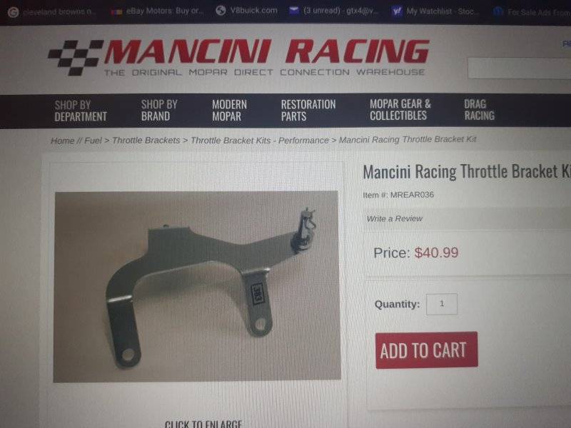

I think I'll just save myself some time and pick this Mancini one up. Looks like NoCar2023 is running one just above this post. I guess then we'll see if I have any kickdown rod length issues
that one is too high your throttle cable will not reach. just need to make a spacer about 1/4 inch with washers or like in post 18. the tabs on your bracket do not need to touch your intake it will stay in place when bolted down. might need a 1/4 inch longer bolt at your local hardware store.
If you end up spacing the bracket you will have to lengthen the rod that drops down to the tranny.
you MAY need to lengthen the rod, if you cannot adjust it so it pulls the pressure lever on the transmission all the way forward, as discussed by the adjustment procedure in the manual.
