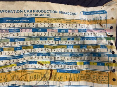

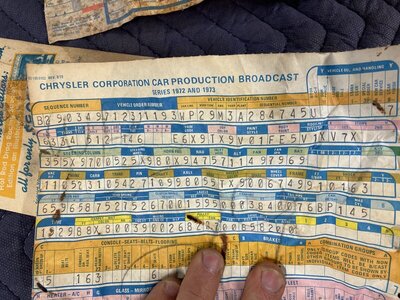

Can someone please help me decode this broadcast sheet I found in my 73 charger?

Step one: does the vin on the broadcast match the vin on your car? There have been many instances of wrong broadcasts found in wrong cars.
33 IMP is correct. Quite often the broadcast sheet in a car is actually for a different car :(

Broadcast sheets contain three things:
1) Administrative info such as the Vehicle Order Number (VON) serial number and other sales or route coding.
2) Sales coding info. These are the codes that, generally, start with a letter and have two numbers.The A-B-C coding. A lot of this coding is listed in online sources HOWEVER...realize that online decoders are a compromise to address codes covering many years meaning they potentially contain wrong information for your specific application. Codes change over the year. What the decoder lists may be correct for 1969 but not for 1973.
3) Two or three digit part or assembly codes. These tend to be specific for your particular application such as engine, axle or transmission assembly numbers, disc brake assemblies, column assemblies, speedometer gears, vacuum check valves, etc.
VIN: WP29M3A284785
W - Dodge Charger, Coronet ("B" body)
P - Premium
29 - 2 door sports hardtop
M - 400 1-2BBL 8 Cylinder "B" engine
3 - 1973
A - Lynch Road, Michigan
____________________________________________
VIN on the following should all match:
Title/Registration
VIN plate on dash (driver's side)
Fender plate (driver's side)
Broadcast sheet
