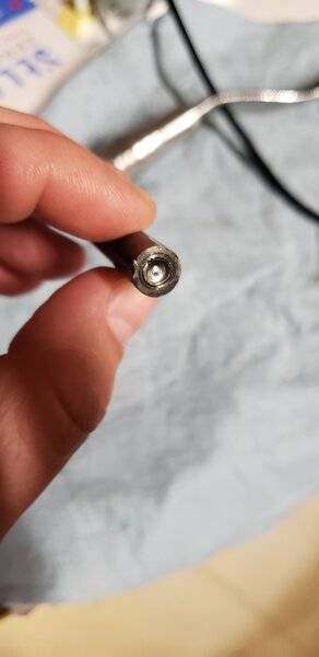

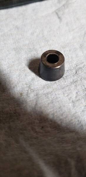

Hydraulic flat tappet lifters. Adjuster dod not back off. No bend but it snapped the cup off the rocker side of the pushrod.
Wait. Do I understand you correctly; the cup broke off the pushrod? Hmmmmm.
Post pictures of the pushrod, the broken cup, the rocker adjuster and the rocker arm. On which valve and cylinder did this happen?

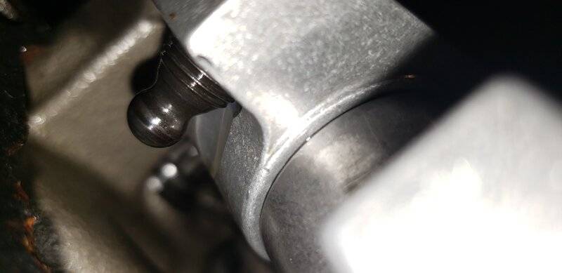

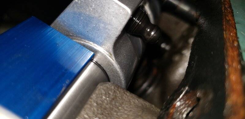

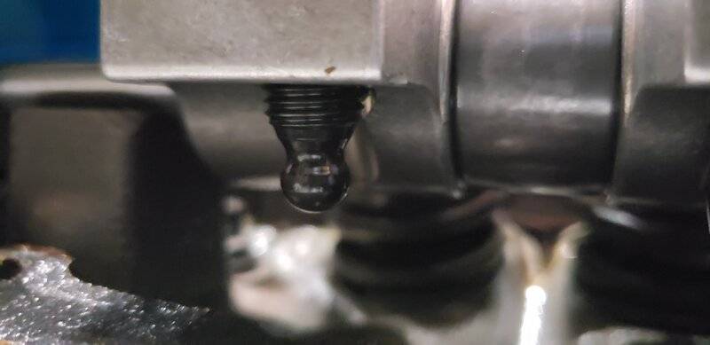

Take a look at the bottom of the rocker arms near the adjuster, see if theres any evidence of the pushrod cup contacting the rocker body instead of just the adjuster... If the pushrod is a little long you'll see the damage you have....

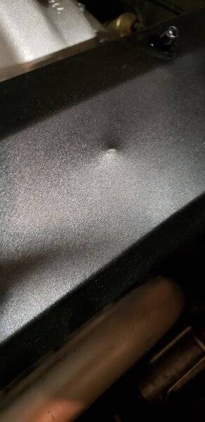

Pics below. This was on the intake of cylinder 5.
20210809_144257.jpg 20210809_144316.jpg 20210809_144337.jpg 20210809_144424.jpg 20210809_144443.jpg 20210809_144516.jpg
I dont see any damage near the adjuster on the rocker... it looks like the rocker may have gotten nicked when the pushrod got displaced.
