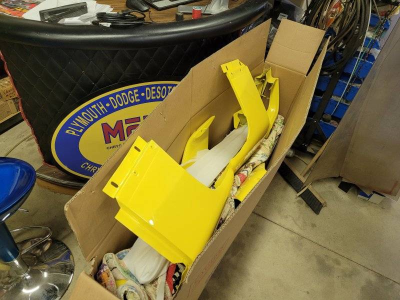

Took a lot of stops in this one horse town to find a F8T5 bulb and a starter ballast.... but another thing off the list!

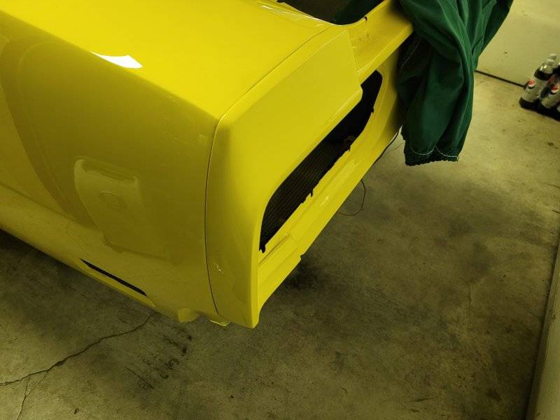

Wiped her down again with cold water and a micro cloth trying to knock more clear nubs off. Car will need a cut and buff before I can float decals on.
Wiped and vacuumed the dust out of the interior, trunk tomorrow I guess as it's supposed to be raining even harder tomorrow.

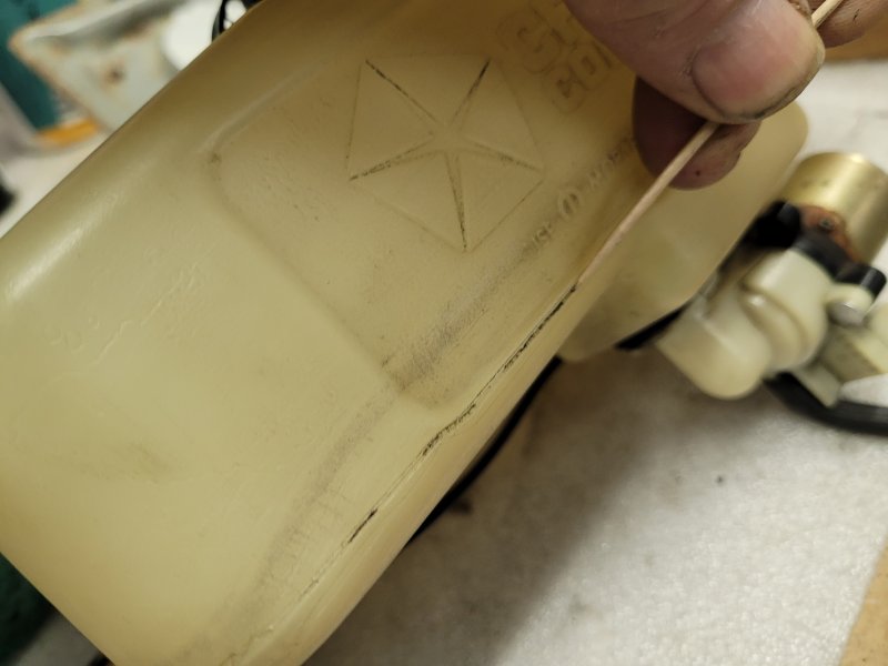

Bugger getting the goo out of the parting line.

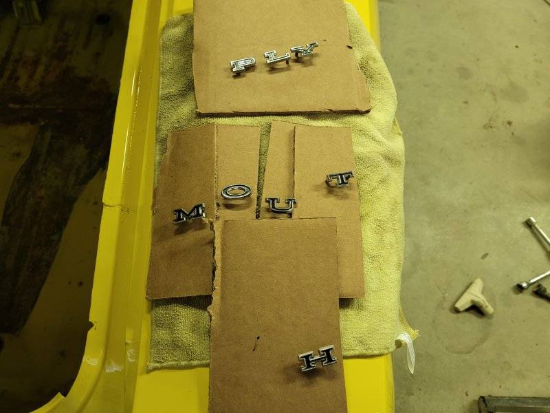

Plymouth tail panel letters I refurbished back in the Winter.

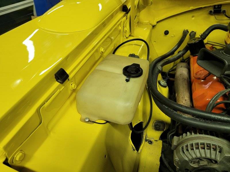

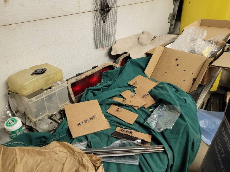

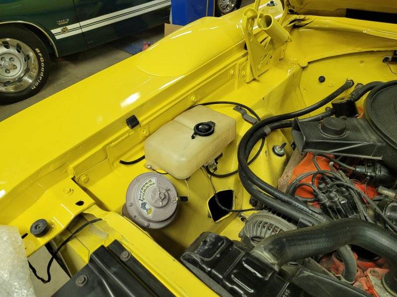

I was sent a PM about the washer container. Yes, originals opened front to back. This container was on the car in 1990 when I bought it, the container was already quite yellowed. It was probably a Chrysler parts counter purchase in the late 70's, early '80's. Someone at Chrysler determined that it made more sense to have them open back to front and started making the service counter parts supply that way, so they couldn't "blow open in the wind". Why most reproduction suppliers in the 21 century started doing the same, duplicating the parts counter piece vs OE.
damn , sorry to see that all happened. i hope for a speedy recovery! been in similar situations never that intense though….
Well now I have to go out to the shop to take a peek.
Well I'll be damned. Learn something new every day! Who says a old dog can't learn new tricks?

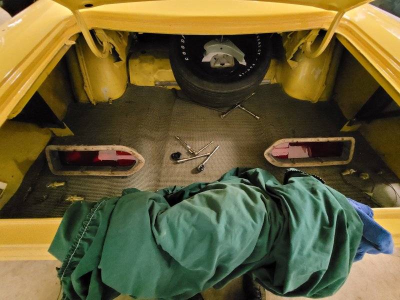

Found a couple hours to putter. Original trunk mat back in.
Spare tire and lug bars back in.

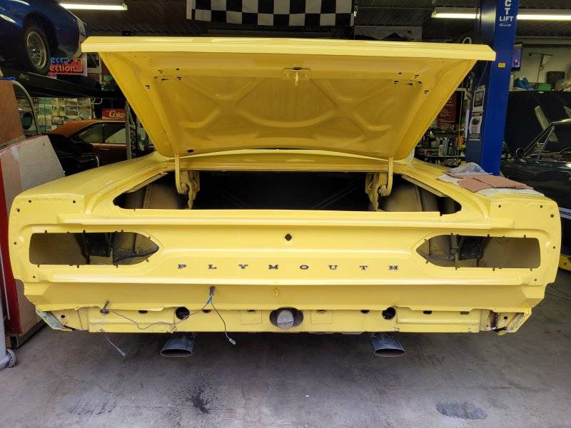

Tail light time.
Time to fill the hole.
Bezel in and tail light installed from behind.
Trunk lock tumbler in and both tail lights snugged up.
Right side light was always not as bright as left for some weird reason.
Went through 7 of my spare old bulbs until I got both sides to match in brightness!

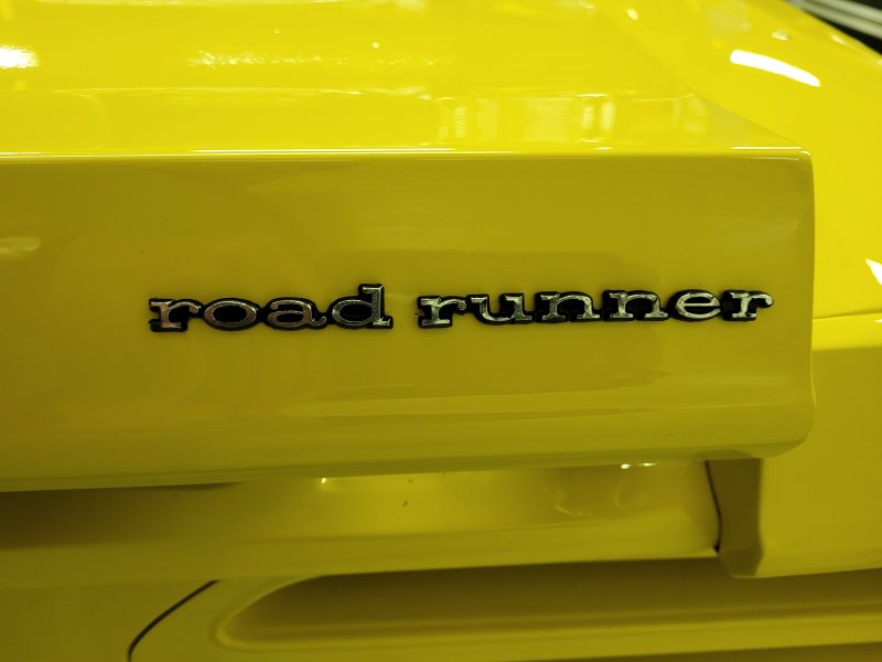

Tab lock barrels for the road runner script into their holes and pushed flush.
Script back on.

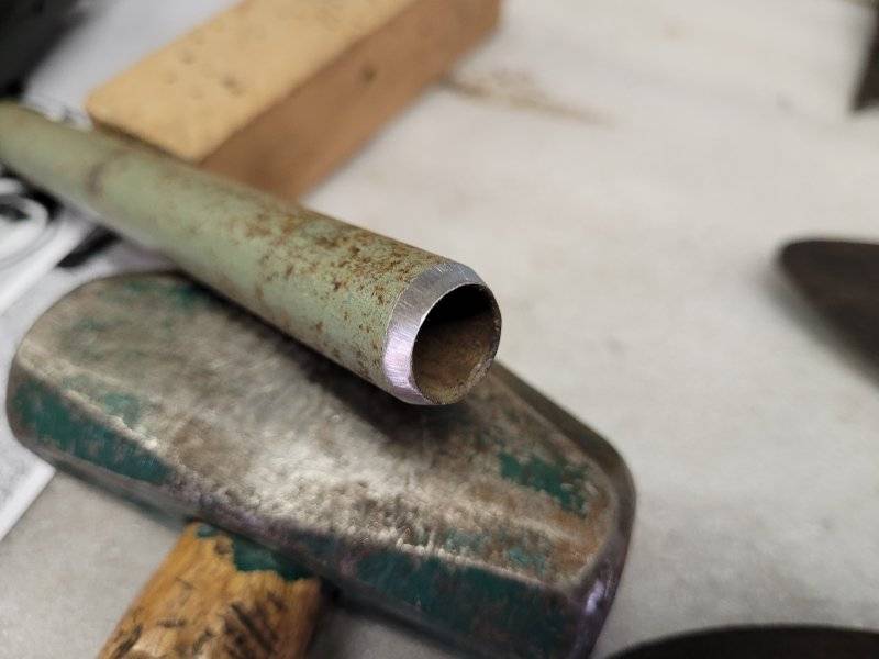

Piece of scrap pipe ground into a hole punch.

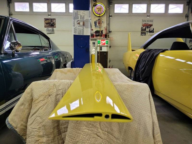

Wing time..

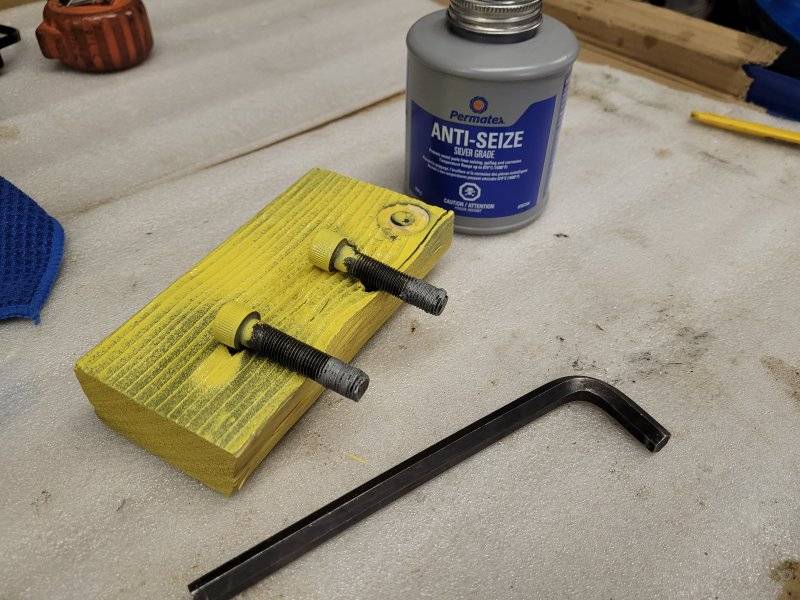

Socket head bolts cleaned up and a bit of anti-seize.
Ready to install the wing.
Small pin limits the wing rotation. Plastic minimizes paint chipping.
Wing tightened to uprights first for nice alignment and then the uprights snugged down to the quarter panel and internal brace system.

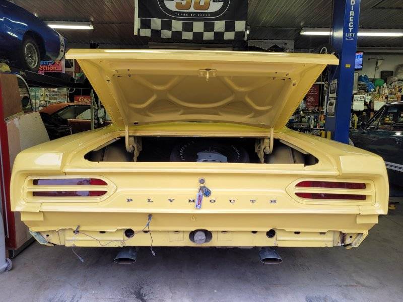

Starting to look like a Bird again..

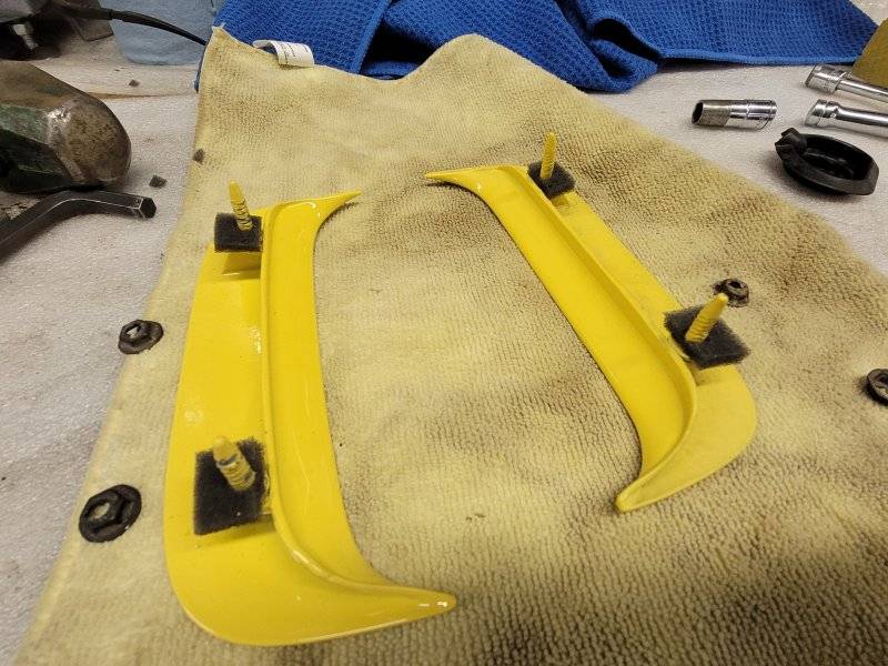

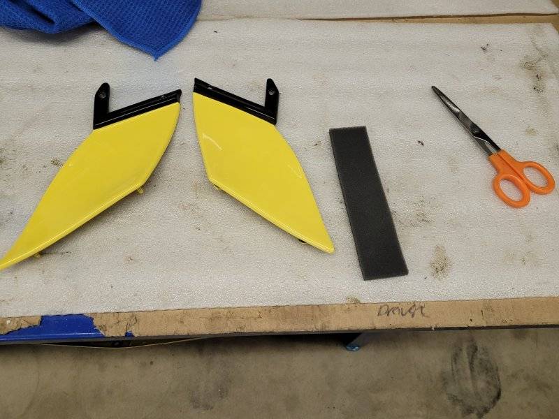

Same deal on the fake side scoops. A bit of foam to seal the stud holes.

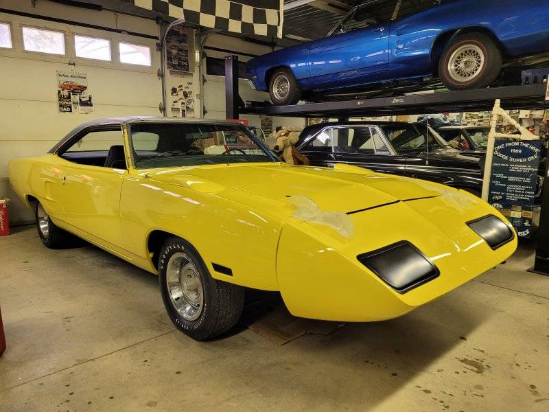

What is that blue car on the other side of the pop machine?
