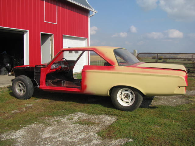

Engine, clutch, and tranny

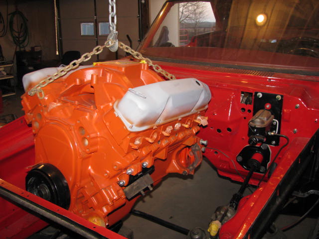

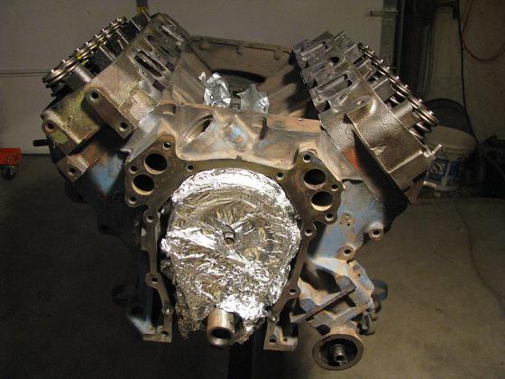

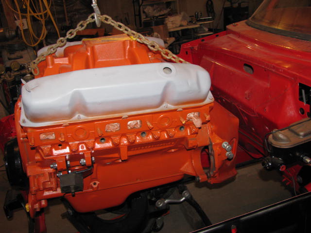

Next thing on the list was to get the engine ready. The tin foil is masking for the timeing chain as I painted the cover separately.

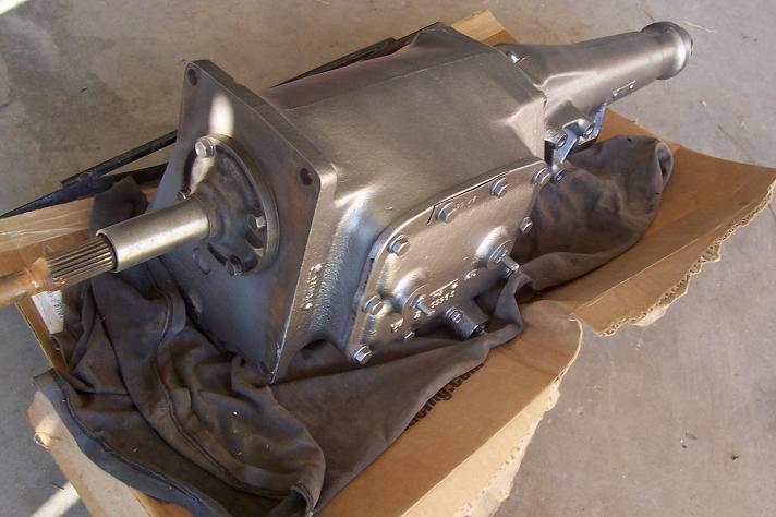

The A833 4 speed was inspected and in excellent condition. Installed new seals and gaskets

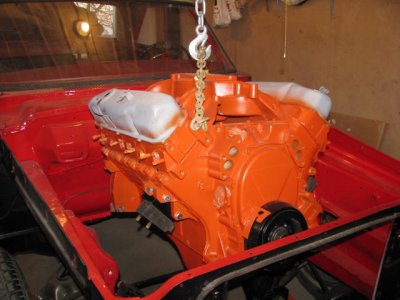

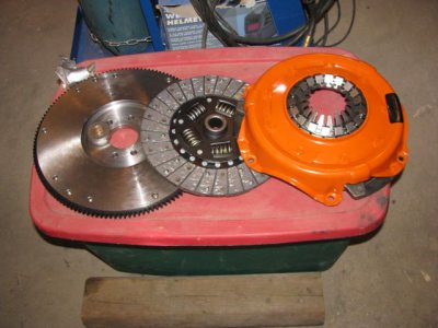

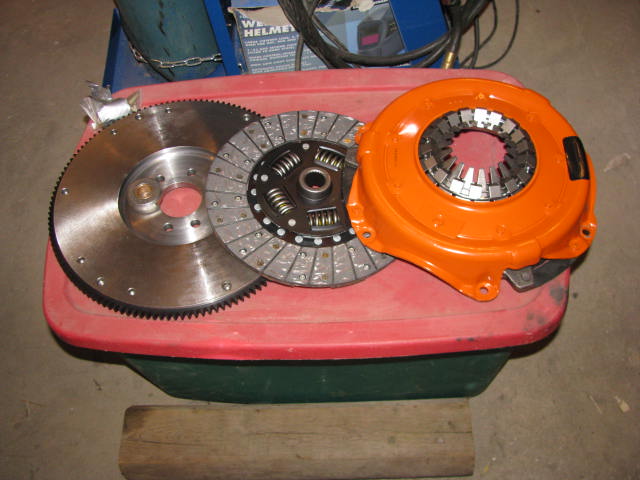

I bought a new Flywheel from 440 Source. It can be used for internal or external balance. The Centerforce Dual Friction clutch came from Mancinni. To be sure of correct clutch linkage geometry, I purchased parts I needed and trans. oil from Brewers Performance.

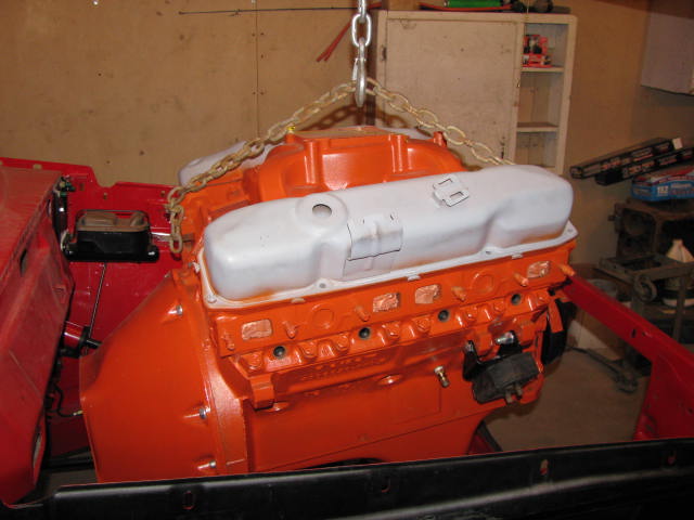

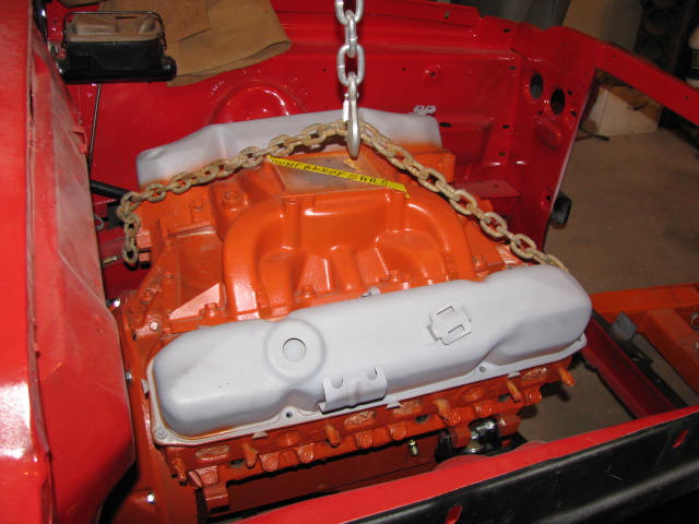

The engine with bellhouse and clutch assembly went in very easily with the Schummacker motor mounts. Had to be easy cause I did it with no help!
The 742 with shure grip and new 3:55gears all rebuilt, were bought from a guy on E-Bay who regularly sells Mopar rear ends. I don.t recall his name, but I was very pleased with his work. I used a 1965 axle housing with all new big rear drum brakes
When I got the Dodge running under it's own power I took it to my body man to get dents out of it. primer, and paint the door jambs and the inside of the trunk lid. The fenders and doors were done separately After I got the Dodge back home, I installed them
After I got the doors and fenders on, I took it back to the body shop for alighnment of the panels and finish sanding . That was about the first of Sept. but due to circumstances, did not get painted till last week. That brings us up to date. Color sand and buff and then Brutus will come back home!!..................................MO Motor 004.jpg64 Dodge 008.jpgDodge 034.jpgDodge 027.jpgDodge 028.jpgDodge 029.jpgDodge 031.jpgDodge 039.jpgDodge 010.jpg

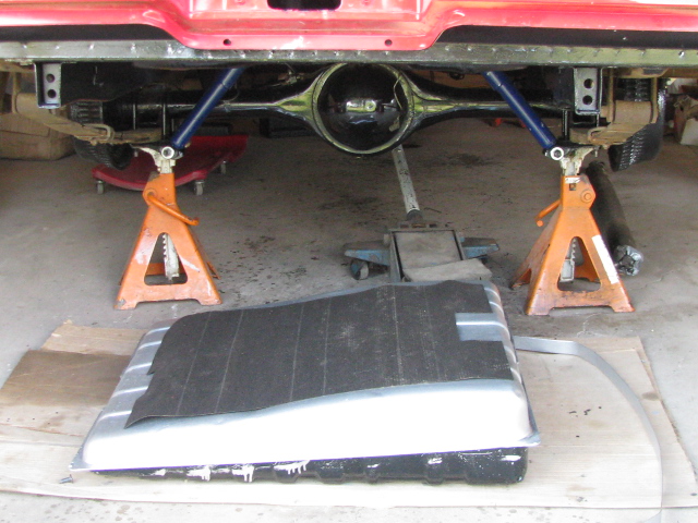

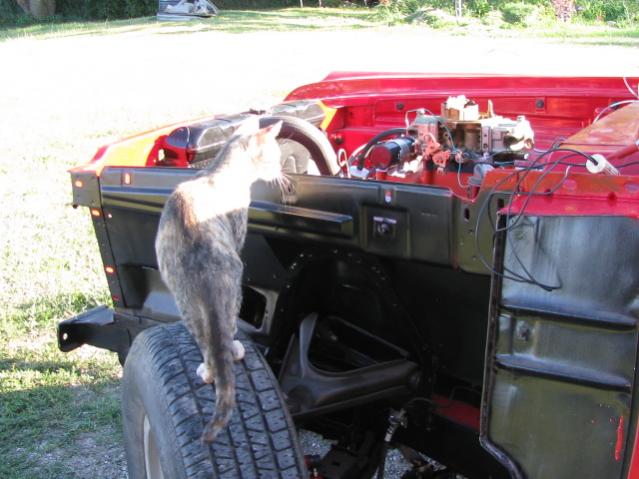

The original gas tank was cleaned, pressure checked, and sealed on the inside. I put a tank pad on the top side. Never mind the paint slop--ya can't see it! The barn cat really is into Mopar engines.................................MOFirst Fire 002.jpgFirst Fire 003.jpgSecond Fire 006.jpg

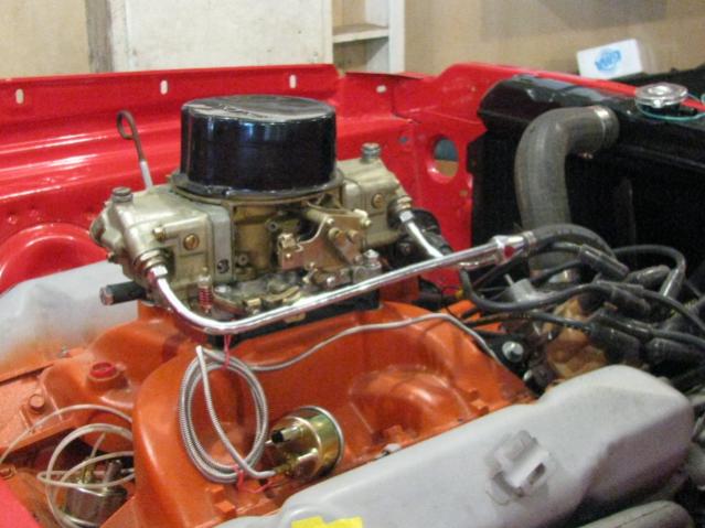

Thank you, on the engine--I have a truck 413 engine that I had planned to build. I want to make Brutus period correct as we did it in the 1960's. However that will be expensive. In the meantime, I found a 1978 low compression Dodge engine. Complete and very low priced and low mileage ( no ring groove or bearing wear. ) Most people could not tell the difference between the two.
Pistons are flat tops , down in the deck a bit. It had 452 heads. About 8:1 compression. I used a pair of 516 closed chamber heads putting in hard seats in the exhaust valve hole and using new oversize valves. New , stronger, valve springs--no port work. Useing a steel shim head gasket the math works out to be about 9.5:1 compression.
The cam is one I got with other parts I obtained. All wrapped up in a towel for protection. I could not identify it by the numbers on the cam. The lift looks to be about .475 intake and exhaust. The lobes appear to have pretty good duration.
The intake manifold is a Edelbrock RPM Performer dual plane. I ground off the lettering and numbers and painted it the Mopar orange. I topped that off with a 750 CFM true double pump Holley carb. I am using the stock rebuilt 413 dist with points. Later I will put a stealthy Pertronix III ignition conversion in it. ....................................MO
