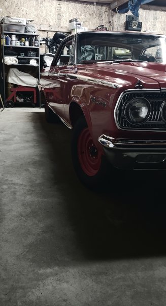

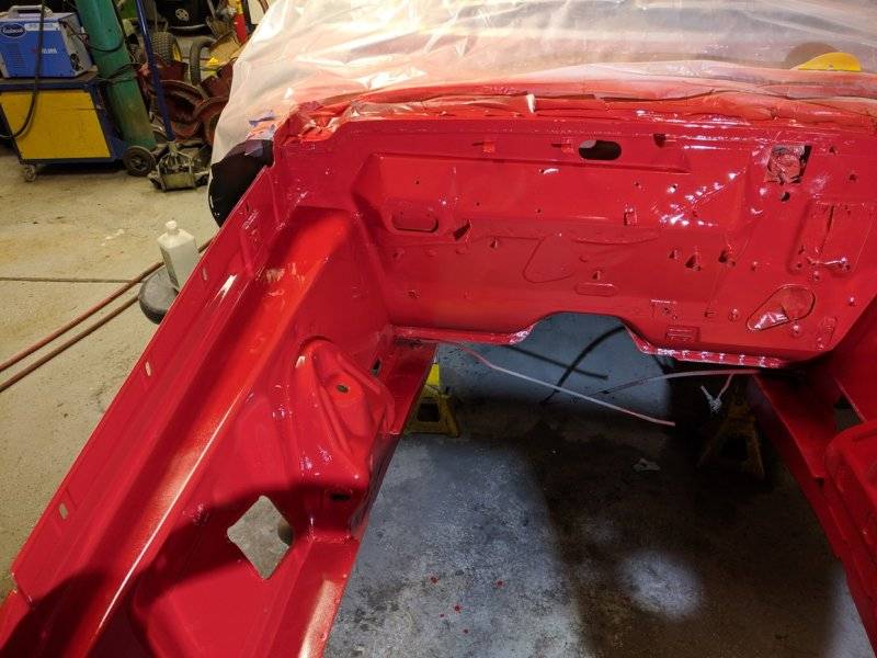

I Used omni base /clear coat 3 years ago. Holds up very well but a little more $$ than single stage. If you can swing it keep it the original color.
Mine was bright red with white sweep stripe.

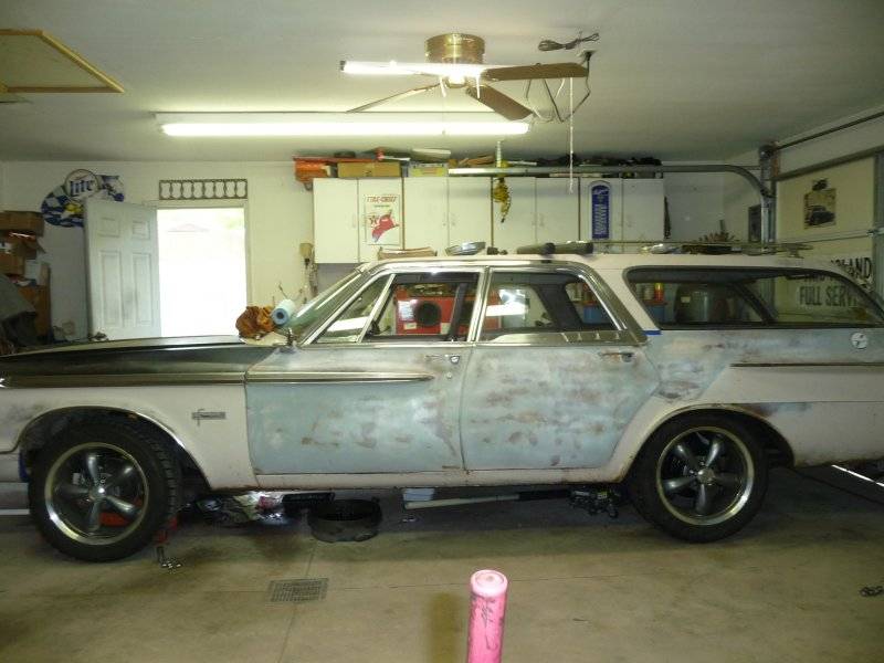

i am getting close to buying paint also . it’s been expensive getting to this point in body panels and supplies ! do i skimp on final finish now ? it would be a shame . after the large investment getting to this point to miss my mark and pick a substandard top coat . we will see , i have yet to place the paint order but it’s gettin real close . yep , i’m in a color change so it will need lots of color. but at least i don’t have to match with a previous color ….i thought picking my color was a difficult choice , now i have to afford it also … times are tuff ….

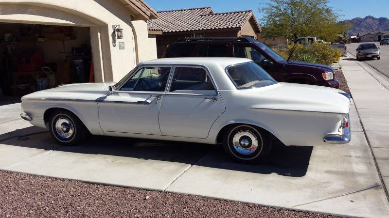

After stressing bout it i got mine from vintagepaint muy '62 is pp1 red and it matched pretty much perfectly and the price was better than anyone else i could find....
I'm a bad painter or this would be better :(

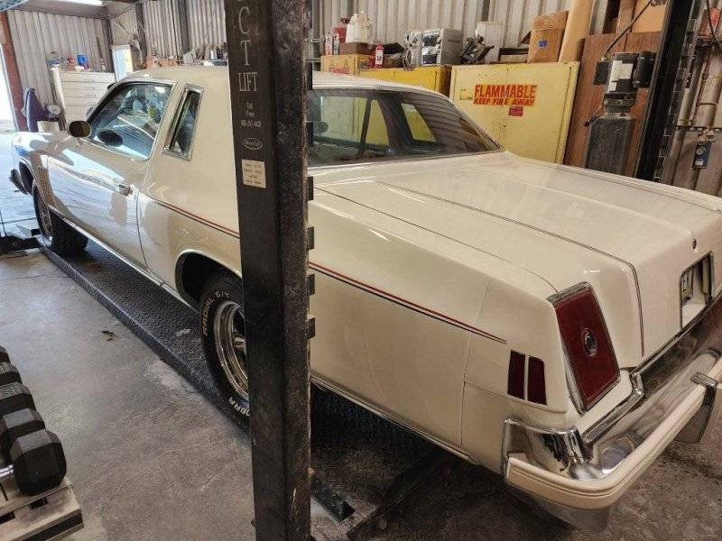

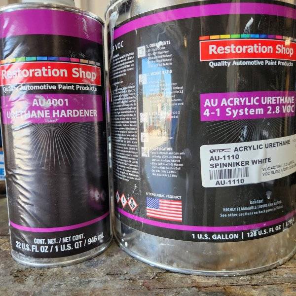

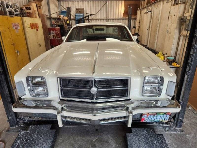

I painted my 70 300 Spinnaker White single stage Acrylic Urethane using Restoration Shop paint from TCP Global. Was very impressed with it and I've made a living doing paint & body since 1972. Mixes 4-1 and gallon of paint and quart of hardener were $224. They also have it in BC/CC for $318 everything included. Other colors might be a little more but still reasonable. You can get it through E Bay.

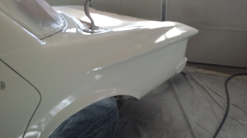

I used Wanda base/SPI clear. It's good paint. AkzoNobel is the parent company. They also make single stage in U-Tech which I used for ermine white on my 62. Holds up very well.

Did you get a full gallon of paint ? seen some say can was only 3/4 full.
5 qts sprayable. 3 wet coats no engine bay or door jambs. Had almost a pint leftover.
