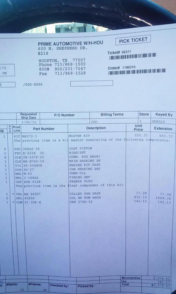

I'm also re-building mines. I have a thread on it. Here's a list with part numbers that I'm getting, it gets a little over 500hp. Well that's what I was told at least.
Hope this helps
