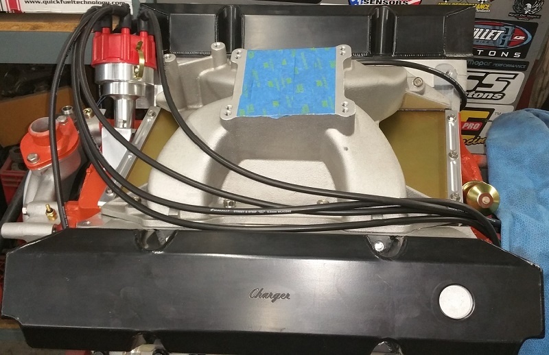

Building a 1970 RoadRunner show car that will be raced "road race" or touring style for lack of a better term. It will have 12:1 pistons, as far as cam, heads, springs, etc I'm open to suggestions. It will either have the F&B 6 barrel refi setup or FAST 30401 kit with their distributor and ignition module. Im no mopar performance guy by far, but looking to get something by the end of the week as we are crunching for SEMA.

Most of these systems require a good vacuum signal at idle to work right. So please choose accordingly.. This is what I am building for F.I.
