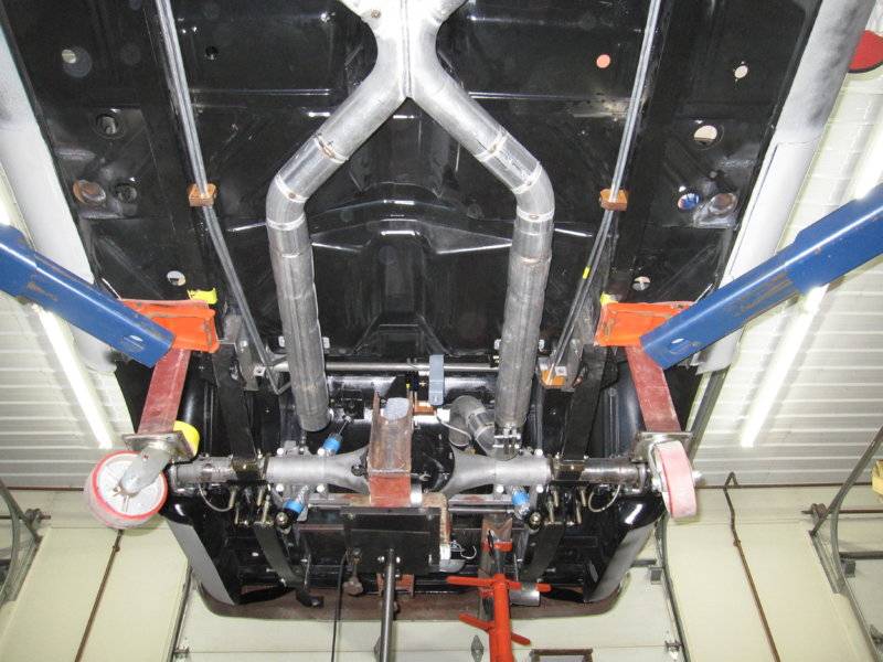

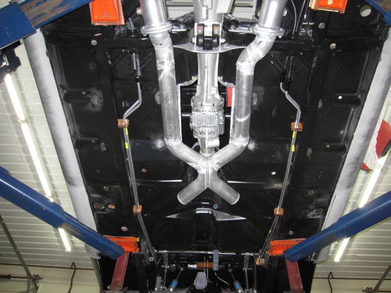

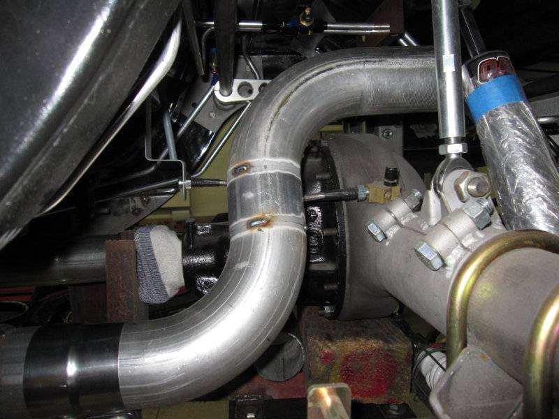

I’ve done it. Not to hard. Several different elbows and bends, chop saw, mig welder. Fitted piece by piece and tack welded as I went along. Once done, tig welded all joints.
My advantage was that my neighbor builds race cars and has drums full of stainless exhaust pipe. (He builds custom headers).
I only did it because nobody sells stainless dual exhaust for a Diplomat with a 354 Hemi.
