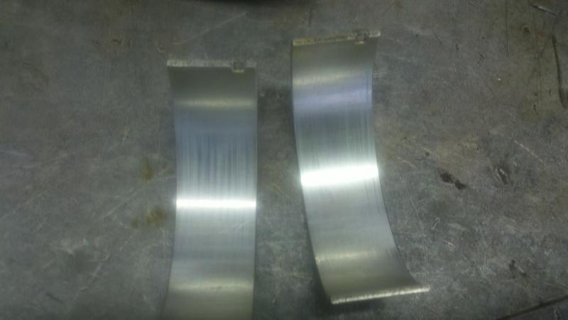

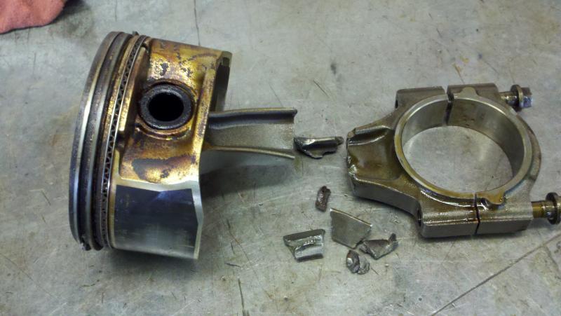

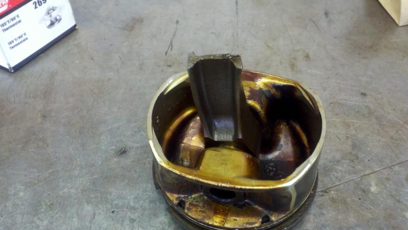

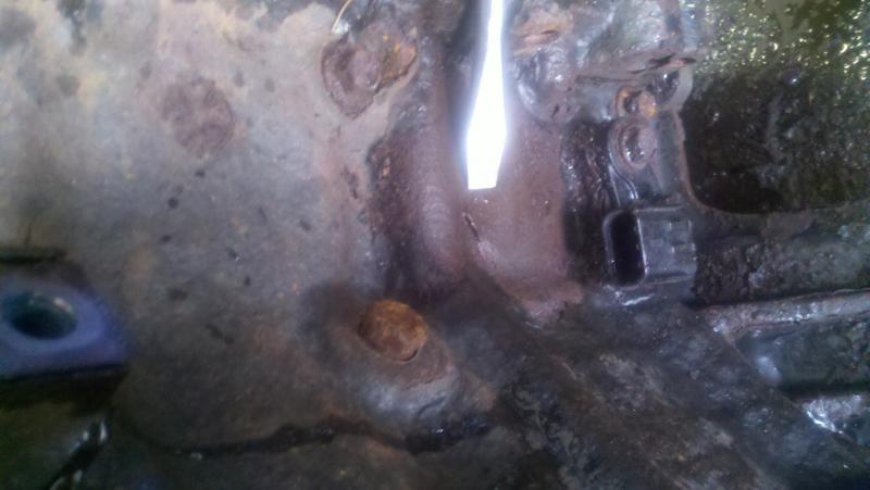

turns out while the truck sat the injector must have leaked and filled #5 cylinder rod broke in half and came through the block.
the rest of the motor was pristine! no ridge on cyl walls, crank wasnt damaged hardly any carbon build up for a motor with 195K
