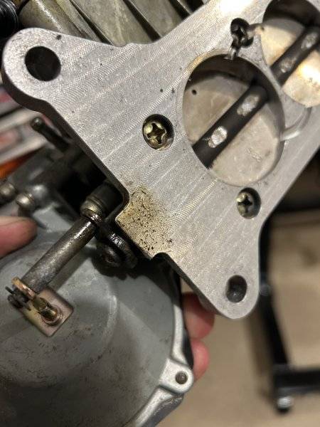

I’m running an Innovate dual AFR gauge and I’m at 14.7ish while idling. But upon accelerating moderately she gets really fat, 11/12, but I have electronic cut outs and will open them to dial her down to 13ish. Running a 4.5 PV too. The secondary metering plates I have no idea what they are, but plan on looking at them over winter. I have the adjustable jet plates and tempted to put them in.
Here’s where I’m lacking, I thought the needle and seat controlled the fuel so if the fuel pump is pumping out 8psi, wouldn’t the needle/seat stop too much fuel from getting the motor. I’m running the hemi mechanical pump through a 3/8 line to the carbs and the fuel pressure shows 8, and based on what I’ve read here, the Six Packs prefer 6. So I need a pressure regulator.
My fuel pressure didn't seem that high, 7.5. Lowered it to 5, had to raise the bowl levels back up to the bottom of the hole. Removed the Promax jet plates on the end carbs and put the metering plates back in for the time being, 4.5 power valve. Most of my issues have gone away. It will be next year before I can get back to playing with it. It's a little lean where it's at now. 418 small block, at least it's responding now. I'll get it.
I too have AFR's. Sometimes I just think that they are lying. I tried all of the 'How to tune a Sixpack'. My carbs have all new needles and seats, filters at the inlets, new Carter fuel pump, Promax base plates, and metering plates,blah, blah, blah. Something was always causing my plugs to look like that. All over the place with power valves and jetting. I knew that the fuel pressure was a little high at 7.5, but, Holley 's I thought should handle that. Well, I guess not in my case, fuel pressure regulator was my jump shot. I sort of hid it, certainly didn't want to look at it, it's down by the fuel pump against the frame rail. You can use all of the tuning info out there for a Sixpack, but it's a base or starting line for me. Some people are lucky and it all just works for them, some not.

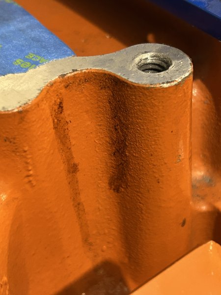

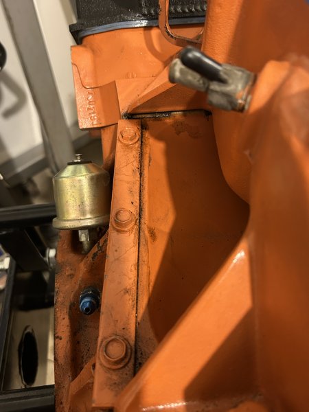

If you have an intake leak oil will be sucked up through the valley. Once you dismantle check the intake. Have a machine shop run the intake over their large belt sander. That’s all it took for me. Intake leaks can also be created when heads are cut without surfacing the intake side.

The spark plug pictures seem to show more of a wet oil contamination than dry fuel soot but it is tough to distinguish from the photos. There is such a variation between intake and exhaust valves. That's why I would suspect the valley pan gasket. Oil could be oil sucked into the intake runners via the bottom of the intake gasket/valley pan drippling eventually down the corners.
Inspecting the gasket upon removal would tell you. Do a compression test before removal to check if the head gasket(s) are leaking. I don't see coolant leaking from the heads and I don't see oil high enough dripping down from the valve covers.
Question: If it's fuel why aren't all of the spark plugs and valves looking the same? Why do some exhaust valves look like they are running hotter/leaner that others? Why just leak oil and not coolant from the head gasket? Was there a cloud coming out the exhaust while running? Smell of oil/Coolant?

It would be odd for oil leaking into one intake runner on each side of the motor (#3, and #4 cylinders). Usually adjacent pairs leak. Sometimes 2 cylinders, sometimes 4.
As stated earlier, a leaking head gasket will not present oil as shown in this case. Other plausible explanation have been given.
