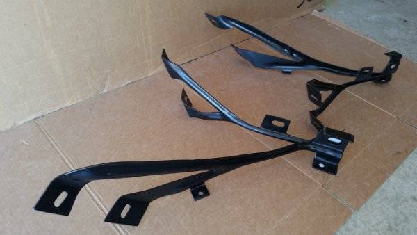

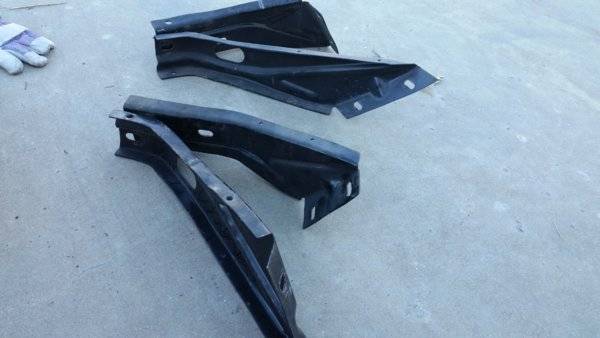

Here are some pixs of my lightweight bumper brackets. Now remember, I am just holding up a fiberglass bumper with these brackets.
Fronts before
Fronts after making them lighter
I did the rears also but my picture wouldn't post,
saved about 18lbs
Note: I absolutely would NOT try to hang regular steel bumpers on these brackets after making them lighter.

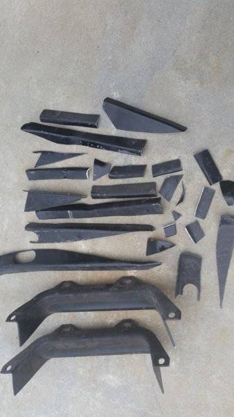

THESE ARE THE REMNANTS OF THE PIECES I CUT OUT OF THE FRONT AND REAR BRACKETS.

Looks good, Mike. So did you take the cutting wheel to the stock brackets, or fab up those from scratch?
Edit:
Never mind. I see now that you said you cut the stock ones. Can you offer a little more on how you cut them?
Edit:
Cut them with my handy dandy Harbor Freight $25 electric cut off wheel.

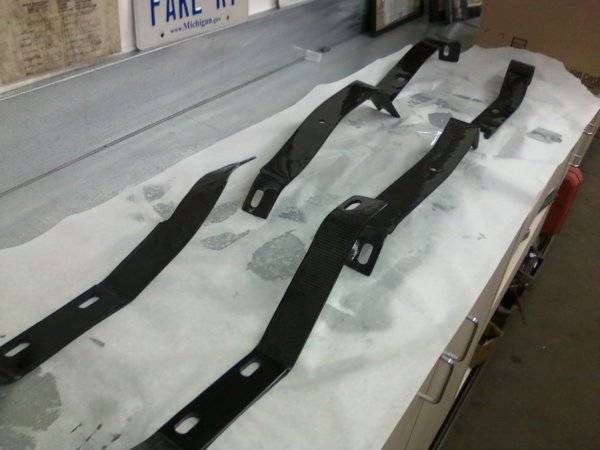

Cabon fiber here, 2.5 lbs for all. Still use the stock bumpers.
