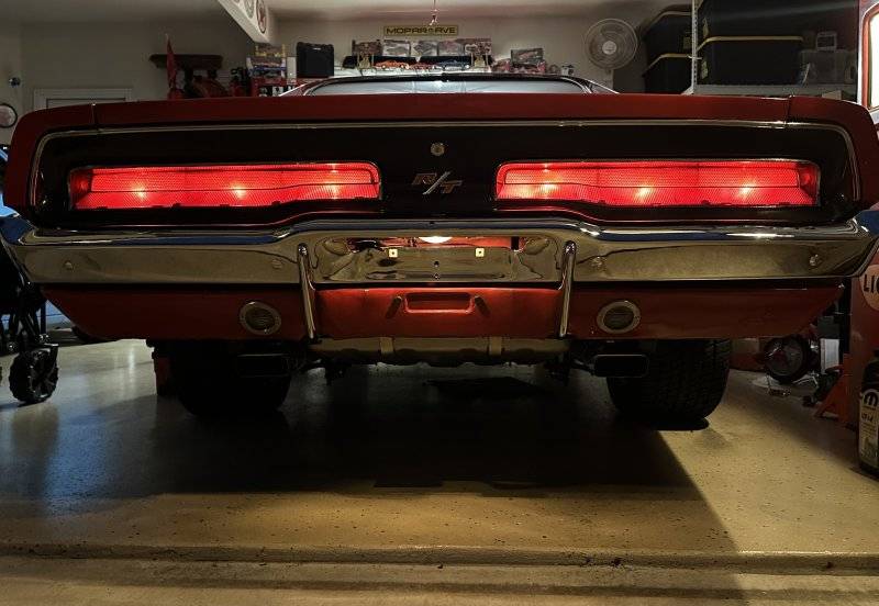

I had my bumpers and guards rechromed.
What should the chrome bolts be tightened to? 5lbs?
Also the bumper guards to bumper?
Lastly the bumper mounts to rear of car, and bumper guards to lower mount.
Also would the fronts also be the same.
I can’t find the information anywhere.
Thank You

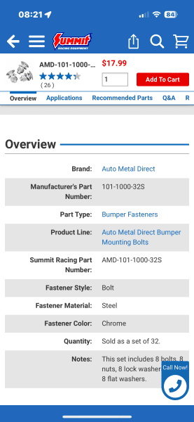

bolts from AMD that were polished.

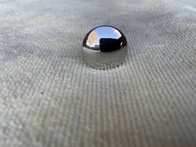

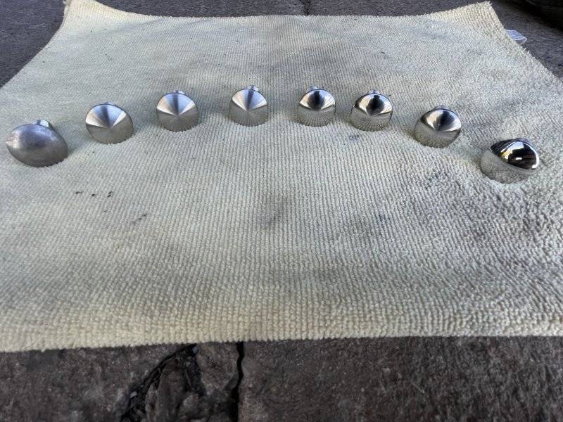

3 pieces 17.99 is crazy. I bought stainless lock steel and polished them. I think you saw it on instagram. It is not original, but lasts longer than the original. Maybe interesting for anyone here.
