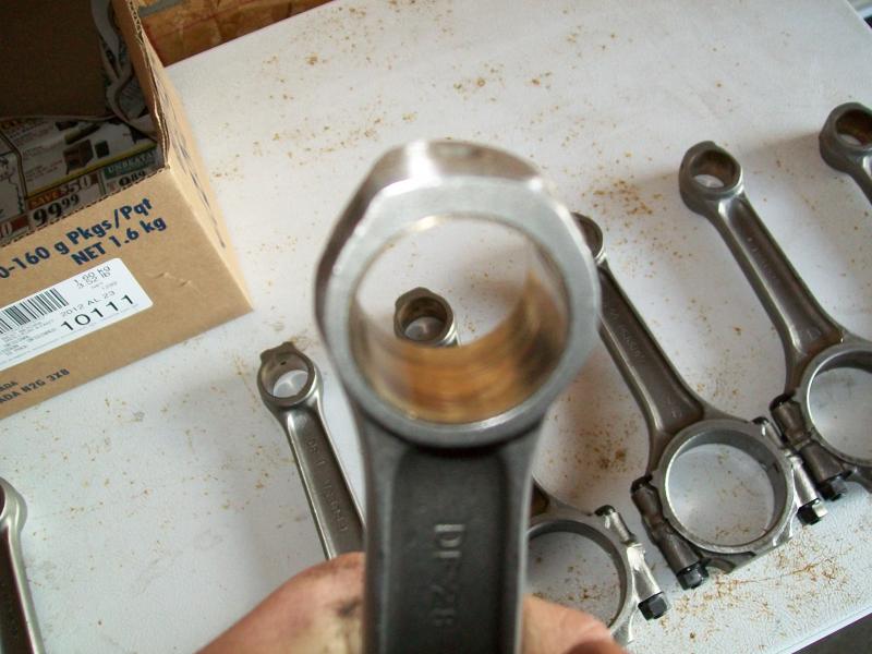

Hi there I have a set of regular ly rods that have been bushed from 1.094 press fit size to 0.990 floating. There is plenty of material left on the bused ends. They dont seem to have uneven wear on the bushings either. As for your other question with machining 0.990 pin pistons for press fit sized pins. You would be better off to just buy a new set of pistons. I'm sure it could be done, but the cost would be very high.

Mopar367;these came out a well-cared for motorhome mill. I don't think they ever saw "severe" use. Heck,I'm planning on using the crank out of that motor;it was that clean! You make a very valid point,but,it's either new pistons or new rods;not sure if I could afford both-unless you guys are buyin'! I've still got block machine work and heads/prep and valvetrain to deal with. Cha-ching,indeed.
