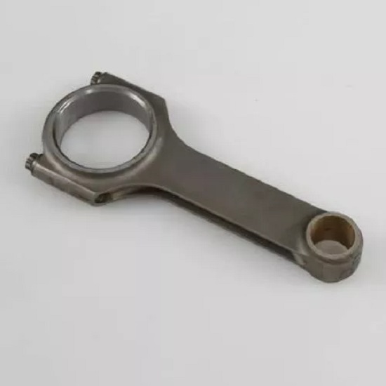

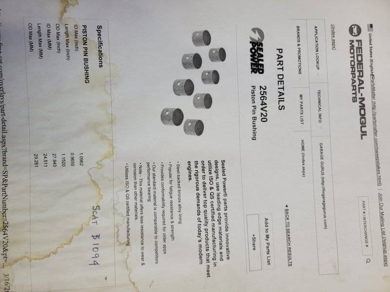

Scat rod bushings would probably work depending on the width. Summit sells them but they just have them dropped shipped from Scat. Try a B1094 bushing.
By the time you buy bushings, pay for the machine work to bush the small end, resize the big end and replace the bolts, you would be better off, and have a better end result to just buy a set of new H-beam rods.
each?...... or in the cumulative? :D
Cumulative. I cannot comment on how much more they weigh, but it's seems generally accepted they are heavy, compared to alternatives. In fact, they may be the heaviest choice for connecting rods, out there.

Scat 440 rod with the 1.094 bushing is $649.
I guess that's about the cheapest old style non .990 rod?
Could not see a weight for them on the Ebay advert.
I get my six-pack rods down to 850 grams (600g BE and 250g SE).
Had a set in my 500 cube hemi and they got smashed to pieces after a bearing seizure.
Once a bearing goes, it don't matter what rods you are using DOH.:cursin:

Summit has the Scat H-beam rods for $577.
The box mine came in shows 596 on the big end and 263 on the small end for 859 total.
The stock six pack rods I didn't use ranged from 900 to 935 grams. How's that for a factory allowed tolerance. A pretty heavy rod for still having a 3/8" bolt. At least with the aftermarket rods, you get doweled caps, a 7/16" cap screw and less weight.

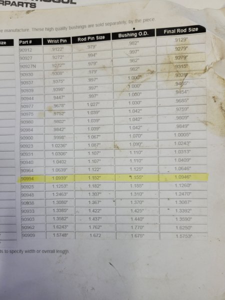

I was planning on bushing the rods if I ever put my 383 back together.. this was all I found back then. Can't confirm if they work but , here it is
