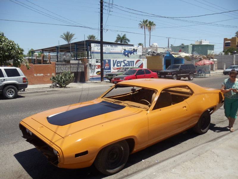

I am in the process of restoring my 71 charger and want to see what people are saying about single stage paint or base/clear. I am painting butterscotch,once the car is finished it will be stored inside. My painter will use whatever I want. I appreciate all the input.
