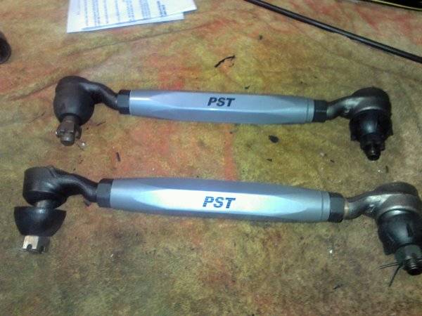

I know u can use the c body tie rods...thats what I'm doing ?
I use the C Body tie rod ends too. Using them is especially beneficial when using big tires on our cars. The C Body tie rods are 11/16 inch compared to the B body tie rods that are 9/16 inch, it does not seem like that much difference, but that more then doubles the bending resistance of the tie rod shank according to Andy Finkbeiner.

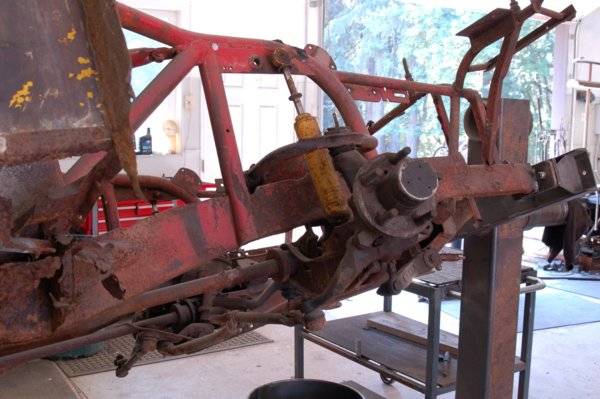

NASCAR used C body stuff but street cars didn't. Just depends what you're working on and who has worked on it before.
Back in the Drum brake days we used Imperial front suspension- coil springs then- was much stronger
dirt track
