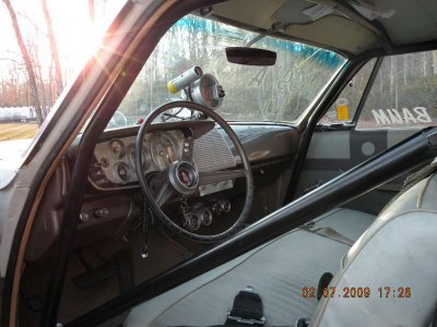

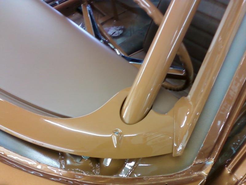

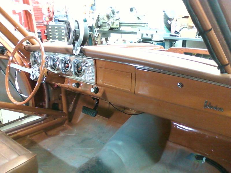

We are still trying to decide what to do with the front down bars. Through the dash or around it. Anyone have pictures of through the dash? Pictures of around the dash?

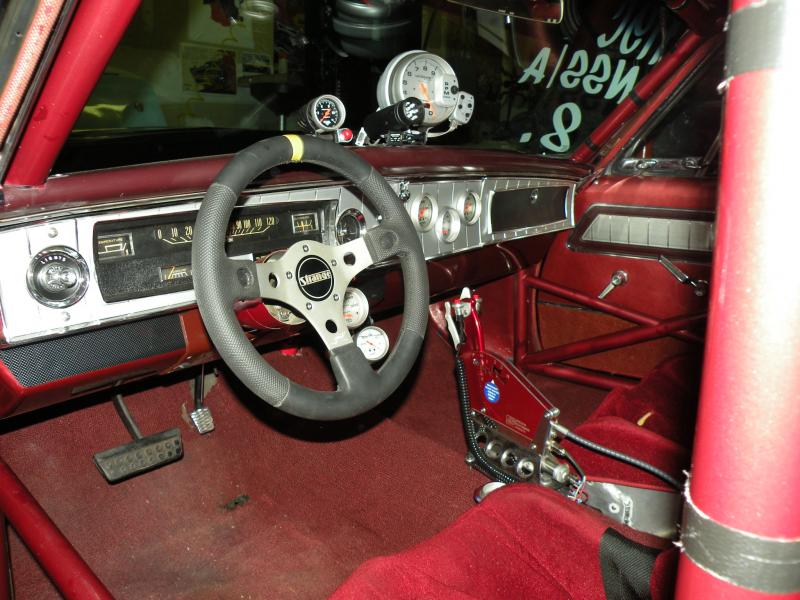

heres mine in front of the dash.
heres mine through the dash

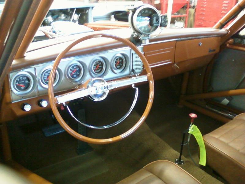

I've had them both ways. Through the dash was well worth the time.

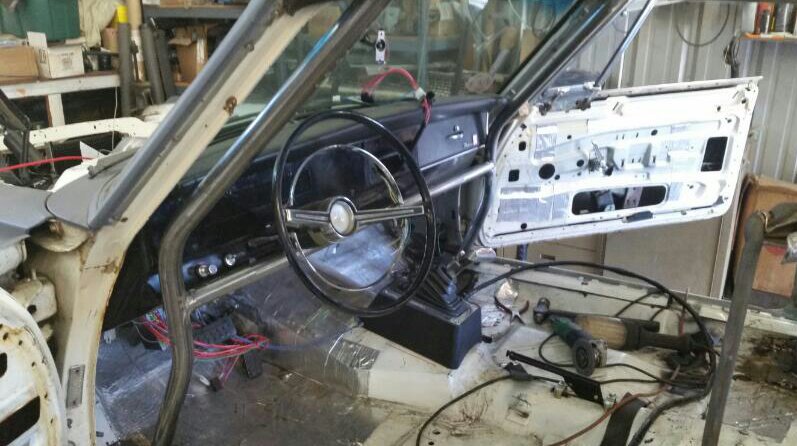

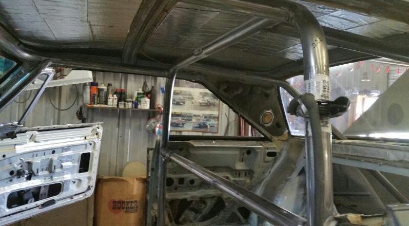

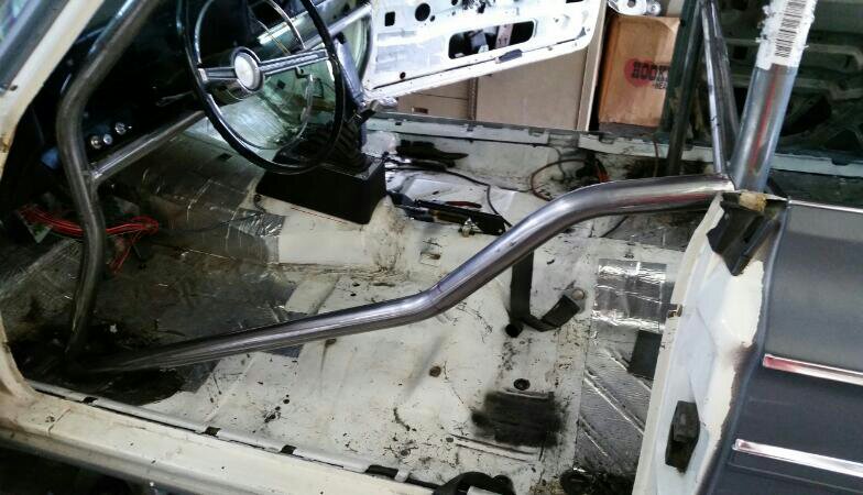

Here is mine so far. Door bars and bars to tie in the shock braces still need to be done. Kidney bars left to do as well
It's looking great, keep up the good work

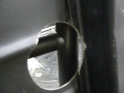

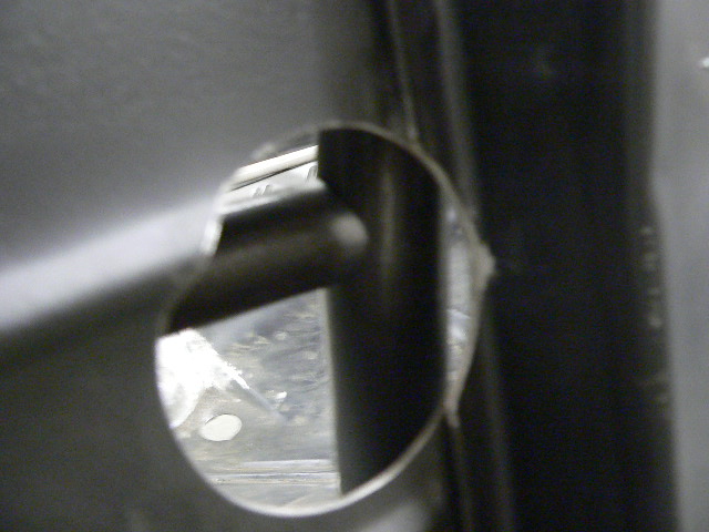

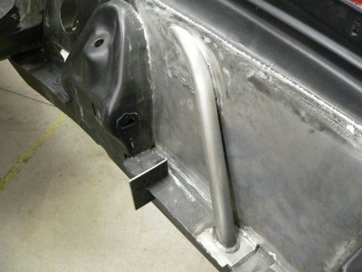

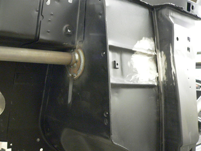

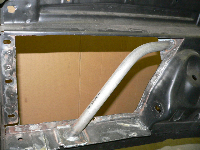

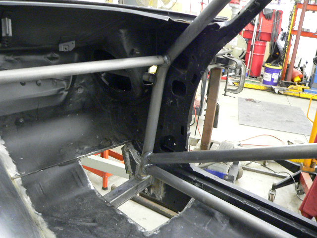

Front down bar pics. In order to weld the nose bars in in a hole sawed a 4" hole in the A-pillar for access, then rewelded the piece that was cut out back in. I chose to hide half of my bars under the fender which required fabbing new front inner fender shields.
Doug
I like that. I did the magnum force strut braces and they'll tie through the firewall to the front down bars.

We got the door bars done today. They are going to be braced from the bottom too. Then tie into the firewall.
