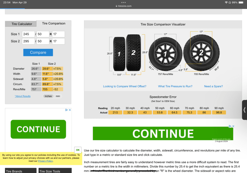

I used this simple calculator for choosing my S60 ratio with Tremec T56 6 speed conversion. I was able to play with wheel and tire size combinations till my brain hurt. I was replacing my 8 3/4 3.23 to the S60. With the combo and tire size I picked a 3.55 ratio Tire Size Calculator
Thanks. Like you said, I’m about on the edge of ‘over-geeking’ it myself.
The calculator is helpful.
It really helped me work out the different Speed/RPM ratios for each gear. I wanted a descent RPM/speed combination in 6th gear for the freeway while not making 4th gear be a useless mess of to low speed at a higher rpm. It was an eye opener to how much effect tire size has on each gear ratio of the 6 speed trans. I went thru 3 pieces of paper on the calculations. : / LoL
