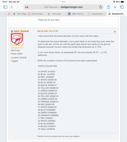

Are you sure that you have the CORRRCT speedometer take-off gear in the transmission?? Your tach may be correct but the MPH may be wrong. Verify the take off gear tooth count or all your calcs will be inaccurate. FSM lists the take off gear tooth count for your application.

Bob…are you referring to the speedo gear? If so, that’s on my list to check as well. Speedo reads gradually more fast the faster I go compared to gps or radar speed limit signs.
YES......THE take off gear is located on the transmission tail shaft and is secured with an adapter body and an O ring seal and where the speedometer cable is attached via a Ferrell sleeve. Disconnect cable first then remove the fork adapter holding the gear housing to the tail shaft.....expect lubricant to come out when removing the adapter. The FSM shows the assembly.

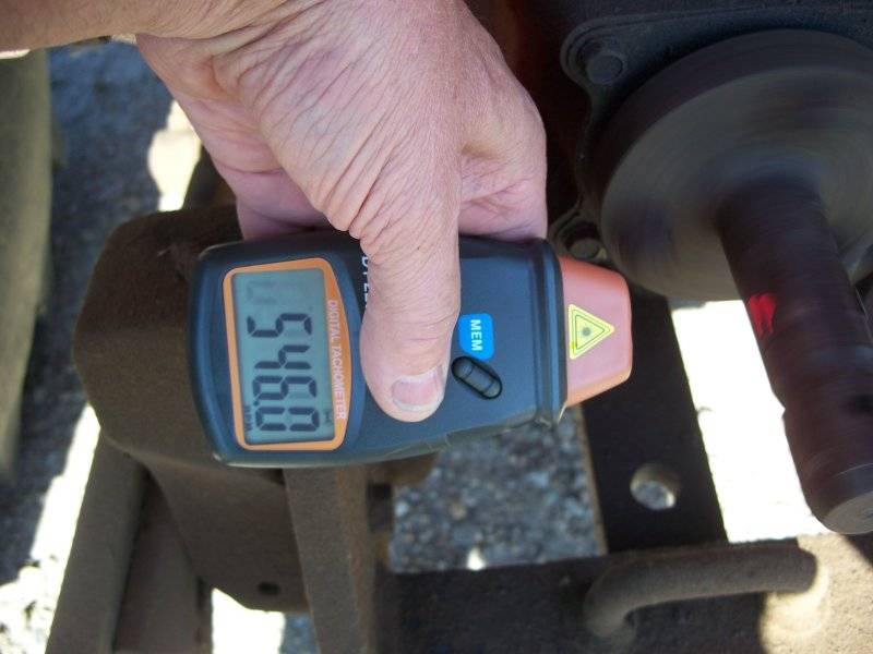

I bought one of these cheap digital tachs years ago. Mainly use it on the diesels, the picture is checking 540 PTO speed. It was less than 10 bucks on eBay. You put a piece of reflective tape on the part you are checking and the red beam shows speed.
