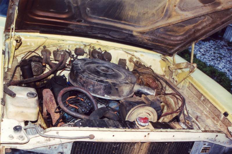

That's funny you said that 440roadrunner. My '67 actually has a '75 440 in it. Thank god i don't have to deal with that mess. I'm in the military and i'm still a Wisconsin state resident. Wisco doesn't have many smog laws, and since i'm in Cali "against my will" (stationed here) i can still register my car in America's Dairyland:grin:
Here uncle, I guess your age is showing.....I remember the car well......
http://www.hubgarage.com/mygarage/purposebuilt/vehicles/3128/photos/90323
Ah, young nephew, think again. What you are seeing is the transplanted 383 2 BBL that I stuffed in there. Note the log manifolds. The original 440 was frozen up and I wanted to get the car moving so I can register it, etc.. Good work on finding the pics though! When I spoke to the current owner a few years ago he said the engine in the car is not the numbers matching 440 that I gave him but some replacement. The original engine is still sitting in the frozen up condition and he plans to put it in his other MoPar (70 RR I think he said). How to ruin a numbers matching R/T SE Charger by pure vision.
