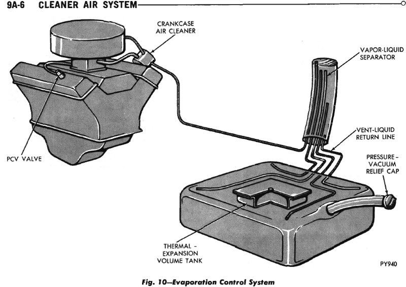

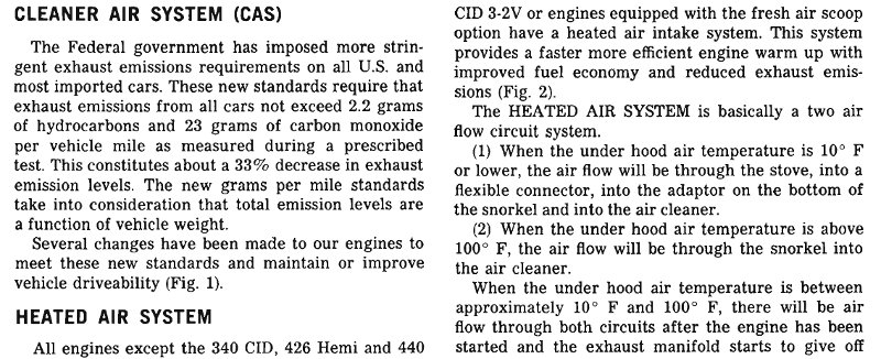

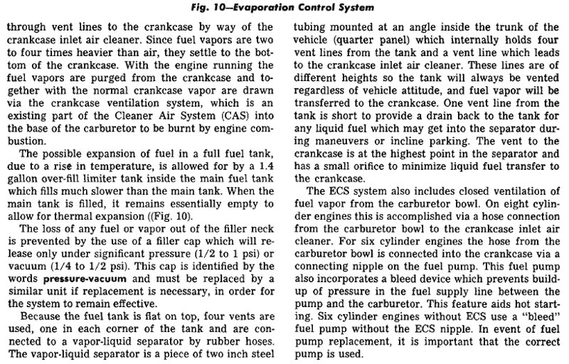

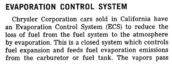

According to the 70 shop manuals it was statewide, IE Chapter 9A Now of course I didn't go around checking cars in southern CA, but it's reasonable to assume that SOME cars meant for out of state either got sold or transferred into CA, just like mine. (The original owner, also in the Navy, ordered it in Oregon specifically to get away from CA, and had Oregon plates on it. Unfortunately, I had financed it through the NAS Miramar credit union, and they required "in state" plates.)

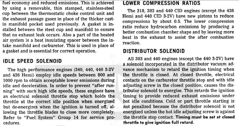

Aha! Way to go 440Runner. Nice work.
"Lower compression ratios by 0.5". Now THAT will have an effect on performance.
So what is the factory compression ratio for a standard (not CAP) 1970 "N" engine (383HP 4BBL)? I'm guessing it's around 9 to 1. From that I assume that mine was 8.5 to one from the factory, and it's 8.2 to 1 today due to wear and time (rings and valves)...
Does that make sense?
Well:
440roadrunner, Thanks for that highly detailed and informative article. I hope this clears up any issues and or answers anyone may have.
The CAP cars were "handicapped" (not politically correct, my apologies) or more appropiately, "restricted" when it came to performance.
Furthermore, it seems ONLY Los Angeles cars received this special CAP (package)
Dont forget the ignition timing and the solenoid! Critical factors ensuring sluggish performance.
