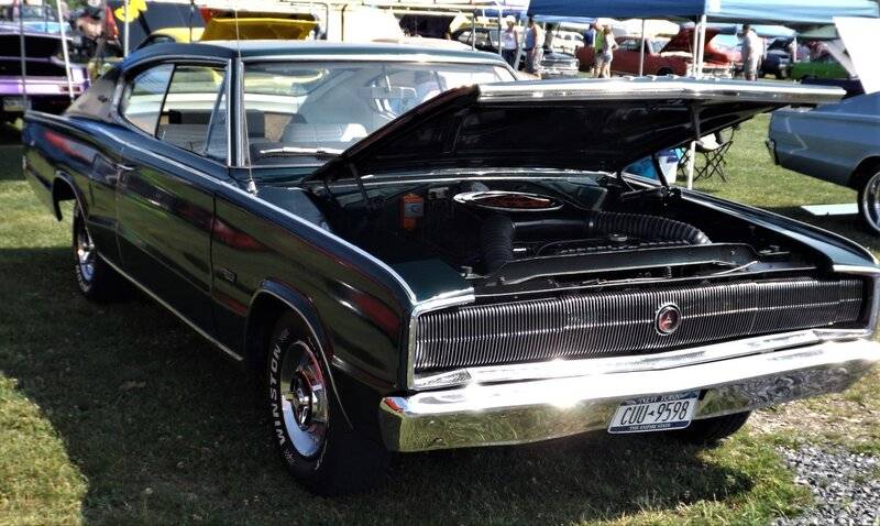

440 motor - has a mild cam but don’t have specs on motor when I bought it. 750 eddy carb, run a mix of 110 and 92 octane gas, just put in new plugs, has old headers (that has the annoying tick tick leak ha).
Motor temp is fine - (it’s been almost 90) - but after driving a little while I just feel like a I lose a little acceleration response - and it doesn’t sound quite like it does when it is colder.
I’ve pondered heat soak with the eddy carb and getting a spacer, wrapping fuel lines, etc - but she shuts off and starts even when hot so not sure.....
So am I crazy? Am I just am sensing a slight hesitation when hot and doesn’t sound quite as raspy when I give it gas......or is it just me? This sound familiar to anyone? Thanks!

I put on a ram airbox years ago, but the 4" air filter would be too tall for a 440.
