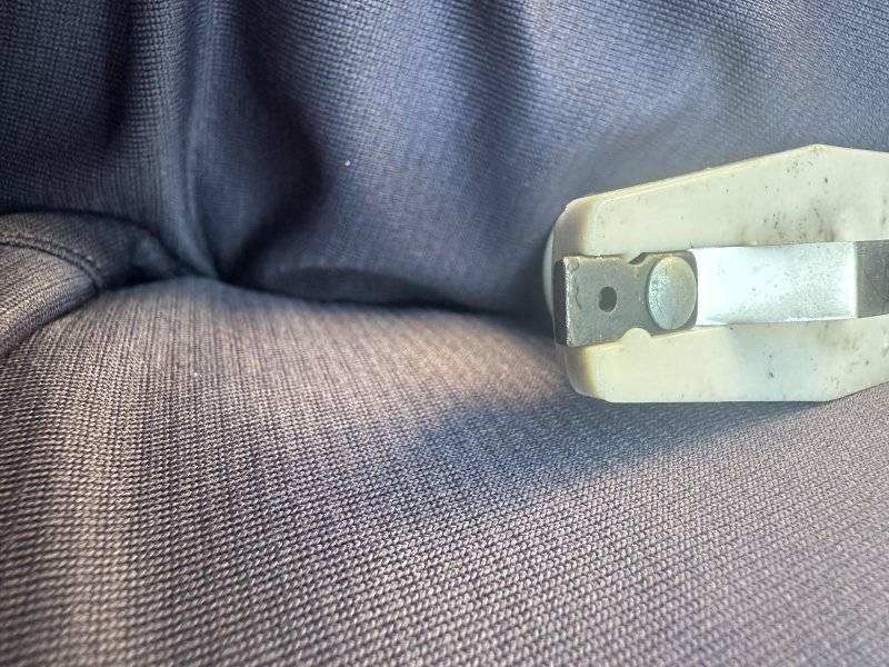

Thank you all for the additional input. One post I came across in another forum described the same condition of ticking when hot and it someone suggested the distributor cap/ rotor. I removed it and there was some evidence of corrosion on the terminals, so I changed the cap and rotor. Unless I’m going insane, that tick is significantly quieter. I do wonder if the distributor itself may need a swapping, but we’ll see. Still trying to determine the why since I still hear it, but much less.
