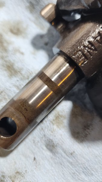

This is bullshit! What do you mean the "ends are larger diameter" ? How do you suppose they got the rockers on ?!?!?
What I "think" you have are pieces of **** stock rockers that have been overtightened to the point they are now oval. Cut the shafts in half, remove the rockers and get a new, decent set of shafts !!

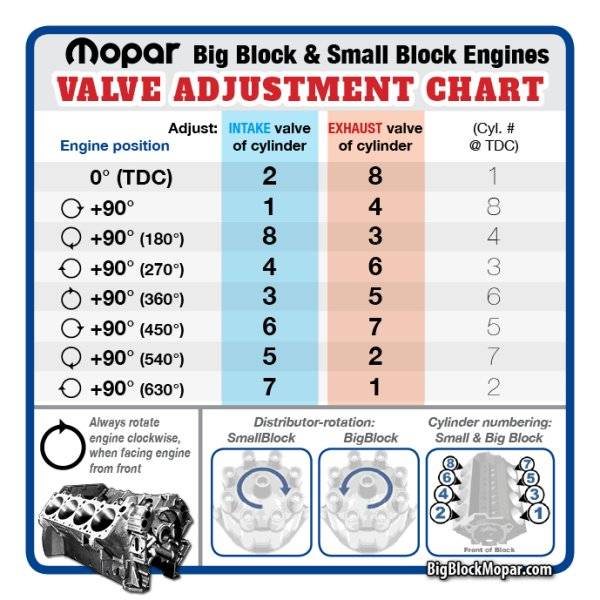

As for adjustment, you can use the attached chart to adjust them. "Zero" lash is determined by spinning the pushrod with your thumb and forefinger as you tighten the adjuster. When it won't spin its at "zero", now tighten 1/4 turn more and tighten the locknut.
Okay, okay. I didn't mean to get you so fired up, just reporting on what I found. That’s *kinda* what I thought was going on, but I didn’t see that happening at 25ftlbs or whatever the torque specs is. They aren’t exactly thin. Assuming that’s what wrong with them, then holy crap someone must have went at them with an impact gun or something LOL. I’ll double check them tomorrow night.
At this point I’m thinking to just swap everything out anyway. At the very least, I’ll know what’s in the car and the status/history of the parts.
Caution here - todays lifter you may not feel any resistance to spinning the pushrod. I prefer to both watch the lifter plunger (factory head) and lightly pull up and down on either the pushrod or rocker while turning the adjuster between your fingers.
The instructions for the lifters call to tighten until there is no more up/down movement. They seem to spin relatively free, so not sure I’d know exactly when it’s at zero by turning them. I tried both methods and I felt the up/down method was a bit more definitive. I otherwise have no preference.
The Cranes had wear issues back in the mid-seventies. That was the first bad set I'd seen on a buddy's '70 440 RR. It has nothing to do with age, you get a good set or you don't - simple as that! The few the OP has look just fine. Knock of the scare tactics and conspiracy theories !!
These are perfect, so far. I have no idea how many miles are on the build. It may have as few as 2000 miles on it.

Buddy, stick with what you have. If they aren't worn on the pads then there is no reason to waste money on a swap.
As far as the shafts being overtightened, it honestly does not take much with stock shafts. In fact, just taking them on and off a couple times will do the trick. And besides, when's the last time you saw a mechanic use a torque wrench !!! Its also worth noting that stock stamped rockers were by no means a precision part ... those shafts could have been crushed flat and the rockers would have still slid on and off (well, not quite - but you get my drift !!).

They spin perfectly fine until I slide them towards the mounting holes. They move about a rockers with in either direction.

"What I "think" you have are pieces of **** stock rockers that have been overtightened to the point they are now oval. Cut the shafts in half, remove the rockers and get a new, decent set of shafts !!"
Agree.
Had a set of shafts that were tightened
way beyond their 25 ft/lb spec. Lifter
noise galore. One of the shafts was
cracked at the mounting holes.
New shafts sounds like the fix.

And/ or possibly torqued down all in a row. Have seen a few cracked in half
With the ends crushed and the center not, the shafts couldn't have been straight. New shafts arrived today. As soon as I feel better, I'll be installing.
As long as they were sitting in the saddles they were straight - just not round !!
If you want the 'best' arrangement for retaing your new shafts [ not squashing them ], get some 3/8" grade 8 steel or s/s rod. Use studs not bolts. Leave enough stud sticking out past the shaft for two nuts. Loctite the studs into the head. Torque the nut to 25 ft/lb [ or even a bit less...] & use another nut to lock the first nut in place.
If you have wear on the NON oil hole side then the shaft was fitted upside down at some time in its life.
You will have to remove the rockers to see how much wear is in the bores?
Certainly not trashed, just normal wear and tear.

I have just removed my Cranes and they are badly scored inside the actual lifter.
The shafts were fine and all the damaged is to the lifter bore.
I have seen on my small block adjustables that the shafts are banana grooved, no wear!
I will bronze bush my damaged cranes and banana groove my shafts in future.

Were the shafts installed correctly? As in the oiling holes are down and pointing to the valves? Or is that just a small block thing? Kim
Having the oil holes facing up [ incorrect ] just means the oil will take a bit longer to flow out of the shafts. The shafts in post #36 look in better shape than some shafts that had the oil hloes correctly orientated.
