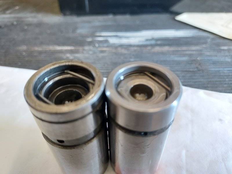

What are the differences between lifters from a 65 and older RB compared to a later 60's 440? Some site show sets that fit year ranges from 1958 to 1965 and others only from 68-72. I thought the valve train in the big block were all the same?? I checked out a lifter from a 67/68 440 and compared it to one out of my '65 413 (top lifter). Same diameter, about .010 shorter, but the oil ring is what threw me off. I know the oil hole in the lifter bore is pretty big, but I would think the bottom lifter wouldn't work regardless. Am I wrong? Also I noticed the lifter for the 68 and newer 440 had some spring in the cup where as mine did not.

Ah, yes..I did notice the seat was a little different. I talked to a guy at Summit too and he said the same thing. I took a couple of the lifters in question apart to see if the springs were broken and they weren't. But that doesn't mean anything I suppose.
As shown in your photo, some can look different, but should still work, if the cup height is the same. I don't know anything about wedge ball sizes at the end of the pushrods. All my old pushrods laying around here for a 426 Hemi are 3/8" ball on the bottom. Yet nowadays people use 5/16" balls on the bottom. Life gets confusing. So yes, make sure the radius of the ball matches the radius of the lifter. I thought all hydraulic cam wedge pushrods were 5/16" ball ends. But I admitted I don't know anything about a wedge.

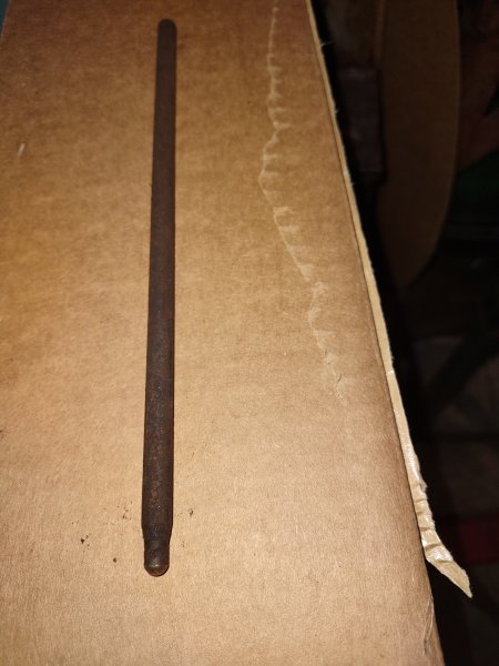

Here is a picture of an early pushrod. Notice it is only tapered on the lifter end.
That's exactly what mine look like. So I have an early model valve train. Great. I was hoping the previous owner changed all that with the cam swap. All well.
The top lifter with the lower oil band is from a small block. They will work in a big block.
So this thing has small block lifters in it?? I didn't know they were interchangeable. They look a lot like ones for a big block from CompCams or even Summit's version.
Somebody realised that the SB lifters could be used in the BBs. So I think some cam companies offer the same lifter for both engines.

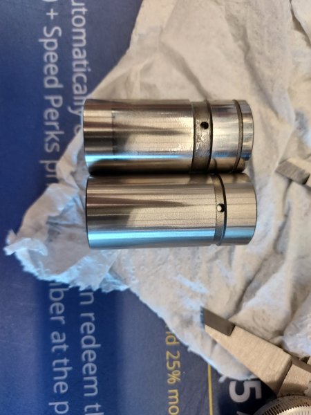

I can see that. I compared both and the sb ones are the same diameter but slightly shorter.
I ordered a set of new lifters for the early 413 motor. First thing I did was measure it and it's .044" shorter than the ones currently in it. The cup seat looks correct but I can't measure the cup height of the old one because it keeps sinking down, as you can see in the one picture.
The one on the right appears to be correct for a 67 and earlier big block(when using 67 and earlier style pushrods).
If you’re putting those lifters on a used cam, treat it as a new cam and break in accordingly.
Since it seems more correct I'm thinking I should just replace all 16 instead of the two that are making noise.
