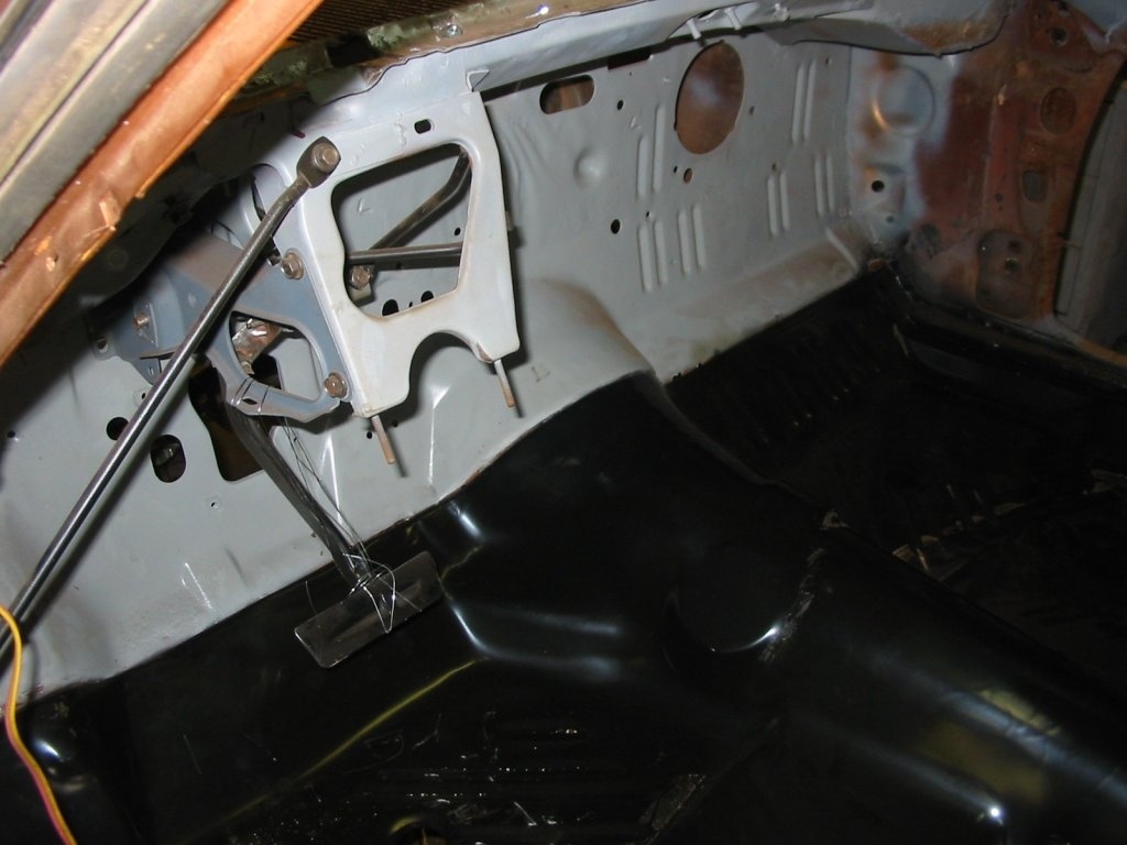

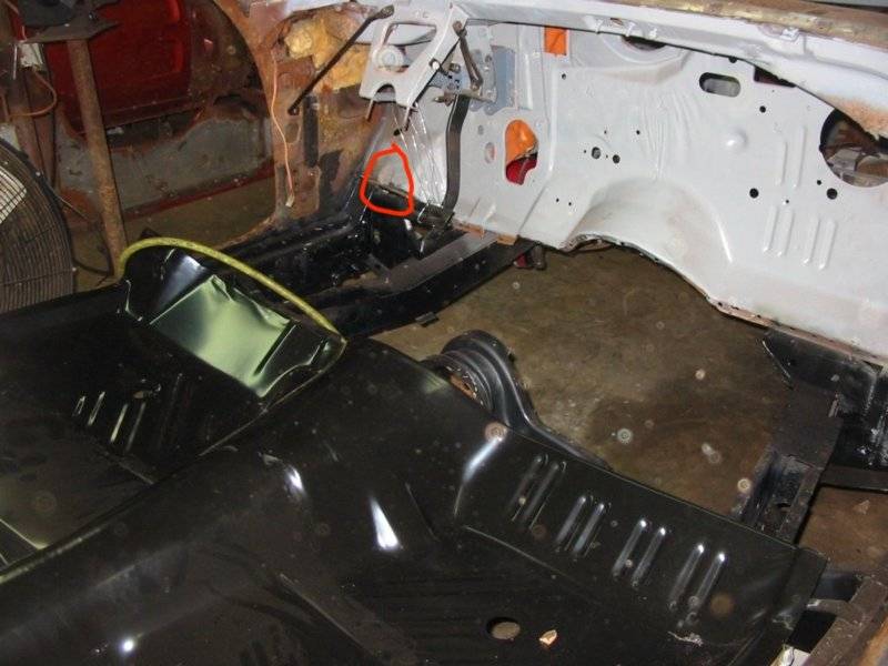

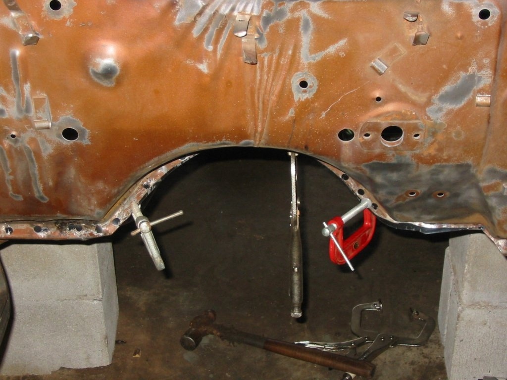

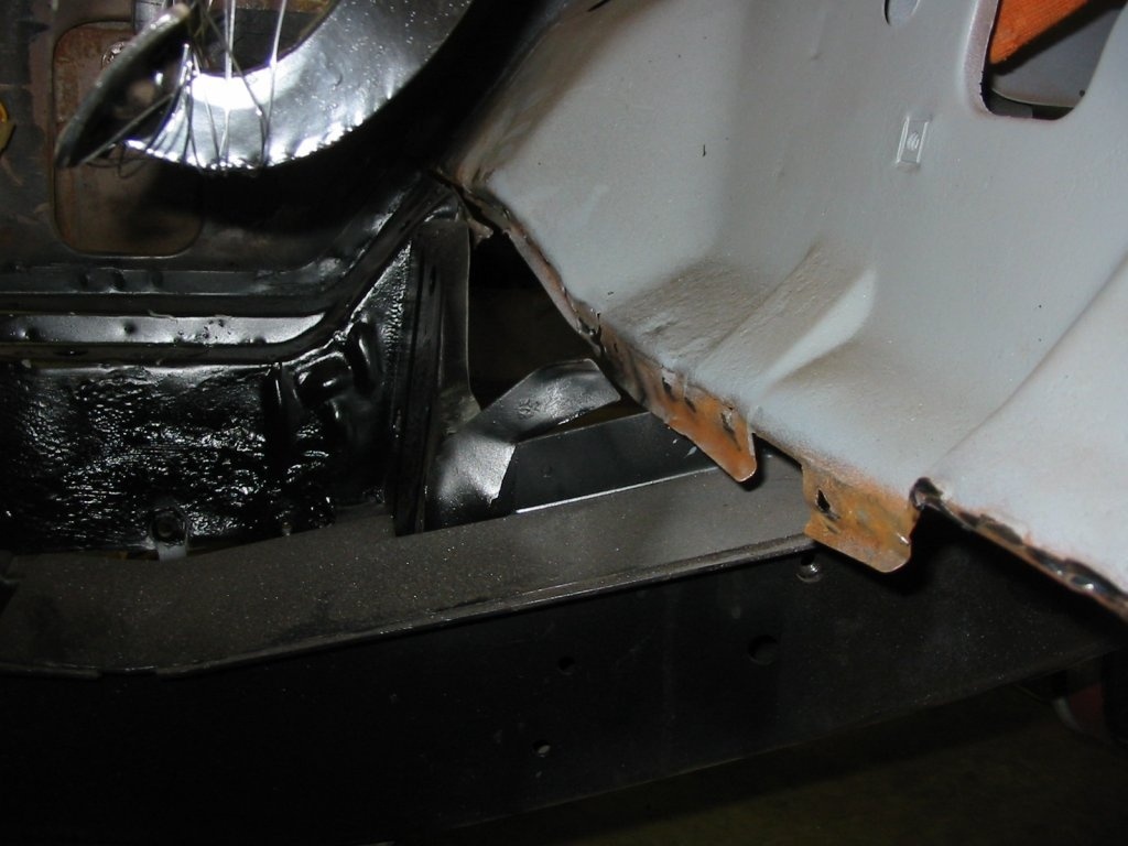

I agree with Poly. I am working from the front to the back 69 my 69 RR. Drill the spot welds at the firewall, try not to use the air chisel, in my case it tore more than I wanted, but I did use it some. When you get to the drivers side its a little more difficult, there are some brackets on the frame rail to deal with, and I had the front fenders off. Don't forget to use weld thru primer. Heres some pics, still looking for my completed pics.
I'm in the middle of a full floor replacement and wanted to say thanks, these pics are incredibly helpful for me.
My car took a hit some time back and while the rockers and rails are square, the firewall is apparently tweaked. Good pics of original metal are a lifesaver. :thumbsup:
In your 2nd pic I see a dimple in the firewall on the outboard driver's side, but I don't see a matching dimple on the replacement floor, is this correct? I've circled it in red. My floor was rotten there so I don't have any good pics of the original.
Thanks in advance!
