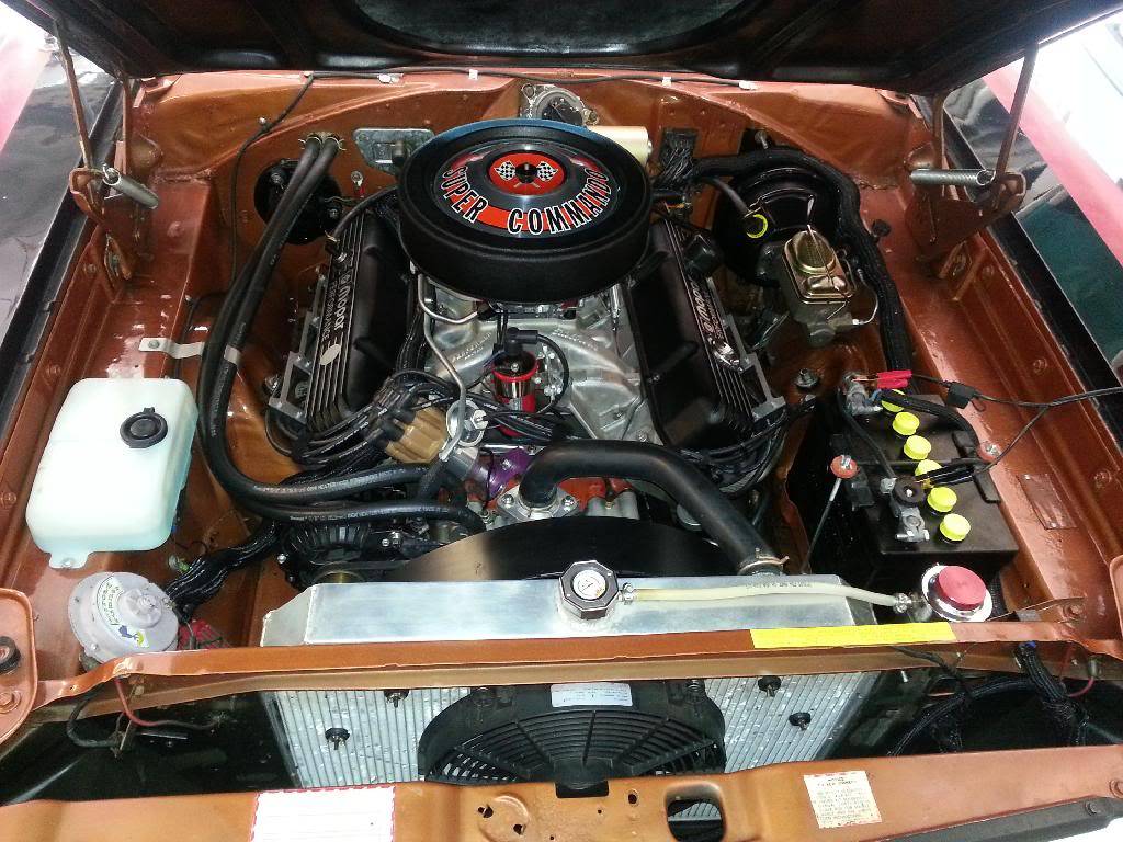

I run the FireCore distributor now and love it. With a MSD 6AL box and MSD coil, no voltage reg or ballast to deal with one wire tuff stuff alt and yellow cap resto battery. Love my set up voltage meter always shows 14-15vdc while running and 13 when just key on.
