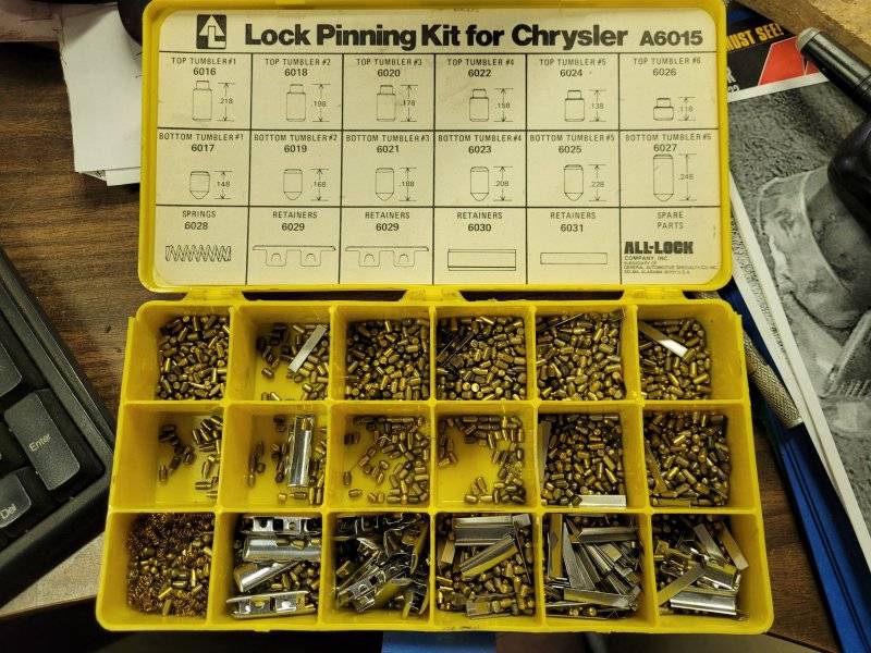

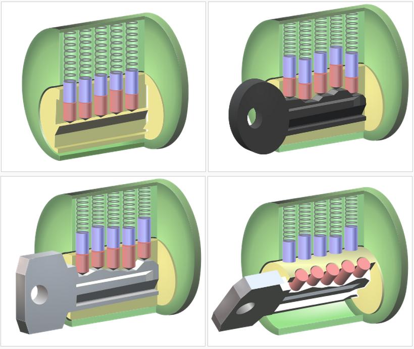

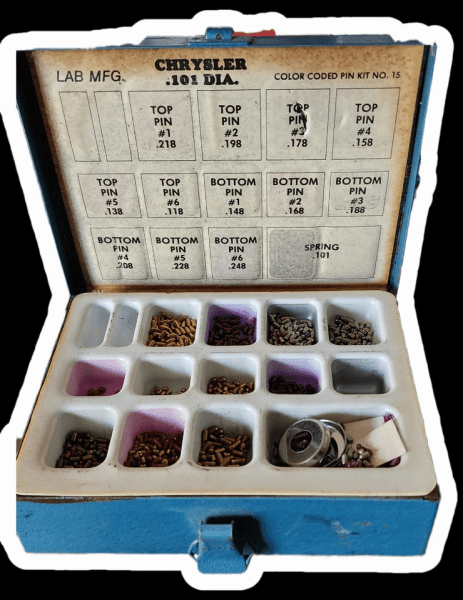

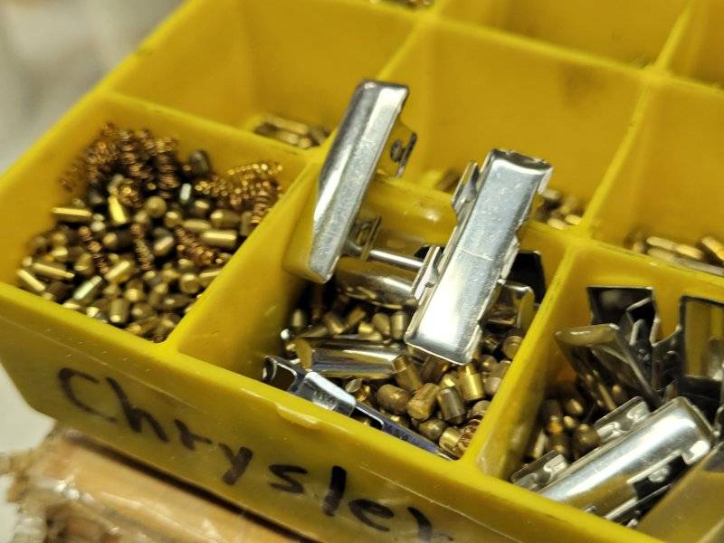

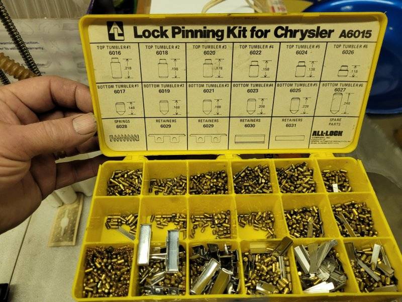

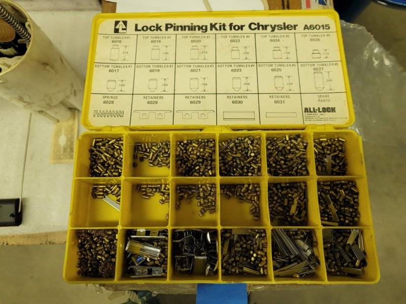

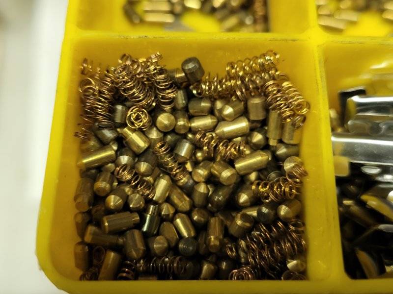

I got some repros and wanted them to work with my ignition key, I said to hell with it while on a Zoom work call (with the cam off) and using a knife and pliers popped them open and rearranged the tumblers, well left one out, and it worked. Not fully proper but super easy and it’s not like it’s a hard car to get into under the best of conditions so I’m fine missing the one tumbler.The only hard part is finding the little pins that match the valleys in your ignition key. Take a door lock cylinder and pop off that little rectangular stainless steel cover. Carefully dump out the springs and pins. I believe there are 5 springs and 10 little pins. Insert your ignition key into the door lock cylinder and then choose one of the 5 holes and insert 2 pins ( 1 blue & 1 pink from the second diagram below) and see if they line up allowing the key to turn. You can see how it all works in the second pic. When the blue and pink pins are lined up with the correct key, the cylinder will turn. The only problem is, it's highly unlikely you'll have all the right pin lengths that match all 5 valleys in your ignition key. This is where one of those rekey pin kits would come in handy or a bunch of donor lock cylinders. I have a couple door lock cylinders where i only used 3 out of the 5 pin slots because i dind't have enough matching pins.
Ouch.
You were fortunate to be at the right place at the right time. Lucky you.Like I showed in the previous thread on this...
View attachment 1768024View attachment 1768025View attachment 1768026View attachment 1768027
It should have arrived with cotton balls in each box to keep it all nicely nice… Same way I packed the one for Jerry @Jerry Hall Make Tommy proud and fix that up will ya Wayne
