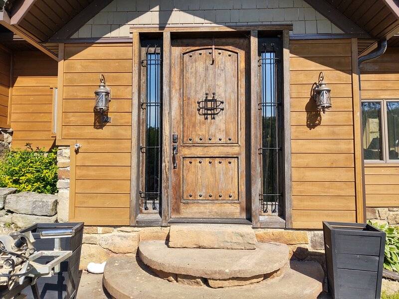

Here's the door, you can see the stained wood is holding up fine
I very much appreciate the input, still not sure what to try as there's a few good options to choose from but it's clear that it won't be the Urethane. I like the idea of something that won't require stripping when it fails since that's what makes it miserable. Recoating the door isn't a problem but when I have to strip the finish then dress up the stain (it uses ebony around the contours for the antique look) it's a real PITA and time consuming..

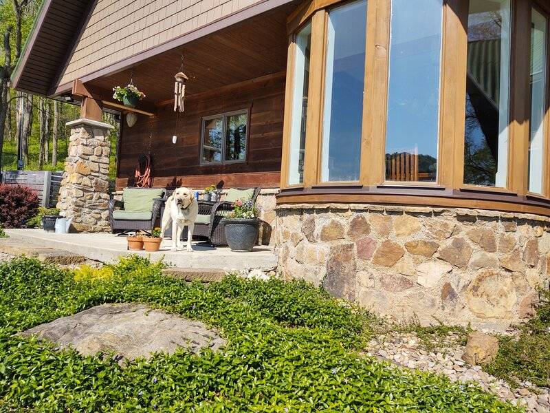

It's not bad, shortly after building the house the siding on the half story upstairs went to **** fast.. maybe because it was partially attic space behind it or that it was the highest area therefore got more sun? We replaced it with Hardy shakes (seen in the pics) so it's cement board now. Then the backside had mildew issues from to much shade, we chopped down 2 trees (1 was to close anyways and the other got hit by lightning) and haven't had anymore problems.

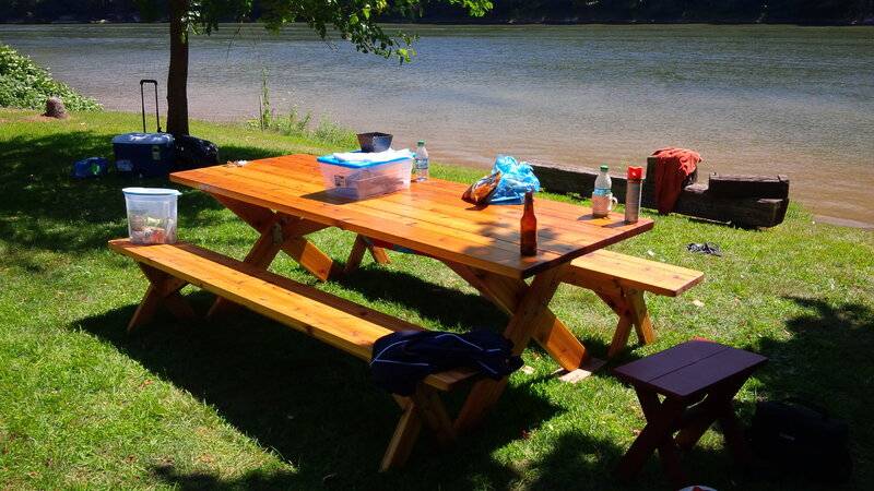

I did one picnic table in western red cedar several years ago with the latest an greatest mix of African and synthetic oils and pigments and did a second table set just painted. The oil table looks good for 1 year and looks like crap by the end of the 2nd year. The painted ones look as good today as they did day one.

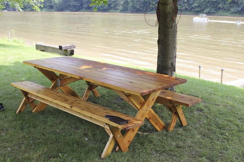

I did one picnic table in western red cedar several years ago with the latest an greatest mix of African and synthetic oils and pigments and did a second set, but just painted. The oil table looks good for 1 year and looks like crap by the end of the 2nd year. The painted ones look as good today as they did day one.

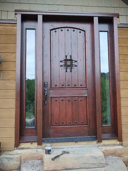

Several suggested Sikkens, having seen it used and it being a stain not a clear I went with it. I actually called the company which is now PPG (product name is Prolux window and door), he said it's designed to shrink and grow and will only need a light scuff for recoat NO STRIPPING THANK GOD! It really brought the door back to life, looks incredible after 3 coats. There was some trimming left to be done in this picture.
Several suggested Sikkens, having seen it used and it being a stain not a clear I went with it. I actually called the company which is now PPG (product name is Prolux window and door), he said it's designed to shrink and grow and will only need a light scuff for recoat NO STRIPPING THANK GOD! It really brought the door back to life, looks incredible after 3 coats. There was some trimming left to be done in this picture.View attachment 1129800

For your door, the combination of vertical surface, stain, no rain, and partial sun you should get several years.
The door looks very nice. Good luck
