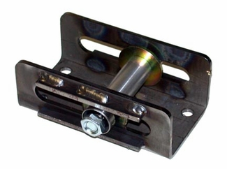

I ran them on my old 68 RR, it did lower the car about an 1" IIRC, not sure if they helped much in 60 ft times or not I had installed them @ the same time as the CalTracs, I ran the original HD leafs for a couple seasons before I switched to the lighter Calvert mono-leafs, that did help a few hundredths, the sliders do free up you springs to travel in an arch & work under a load, so I think they would help to improve your 60 ft times, but IMHFO it's not going to improve the 60 ft times 2 tenths, maybe a couple of hundredths, over a none slider equipped Calvert CalTracs set up
I don't think it would improve 2 tenths either,I am pretty sure it won't,but .05 to .1 would be good,gotta find something why this car won't 60 LOL
