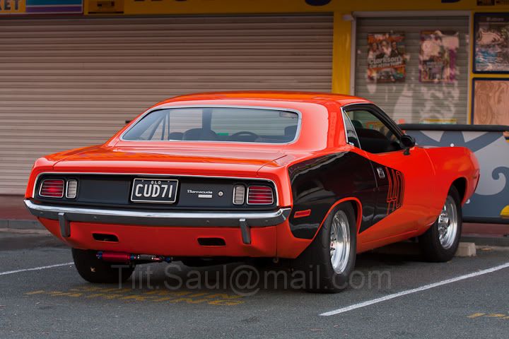

I think the springs are stock #3400044 (car sits low see pic) and the shocks are Competition Eng but not sure of the numbers with the Caltrac bars.

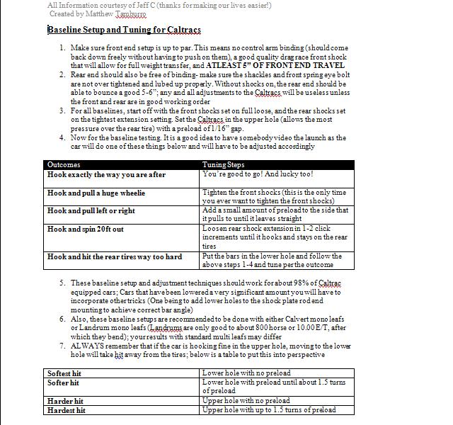

See if this helps.

I can tell you Cal Tracks and drag radials will work with and auto trans. In most cases they'l be quicker than slicks. The key is loose adjustment on the front shock with plenty of travel. They also require more specialized adjustment of the rear shock. Many times a standard adjustable rear shock will not work. A radial needs to be hit hard initially and then the rebound (shock extension speed) has to slow down and not crush the tire. This may require a custom double adjustable shock. Even though Calvert tells you to loosen the rebound (extension) on the rear shock yours appears to be to loose to start with. The tire hits , the front end starts to lift, then it spins and drops. I'd tighten the rear shocks. We run about 18psi. With Rancho single adjustable we ran in the 1.6 60 ft. With Afco double adjustables modified by Mark Menscer it runs consistent 1.4 60 ft. call Mark

You must have 6" of front end travel for the caltracs to work properly.
Put a floor jack under your k-member.
Measure how for the lip of the front fender is off the ground.
Jack up your car until the front tire lifts off the ground.
There is your front end travel.
Exaravmple:
1st measurement is 32"
2nd measurement (jacked up until tire lifts off the ground) is 35"
You only got 3" of travel.
Get 90/10 shocks and loosen your torsion bars (sag) until you get the max lift travel.
THIS IS STRAIGHT FROM CAL TRAC TECH DEPARTMENT WHEN I ASKED ABOUT SETUP.
