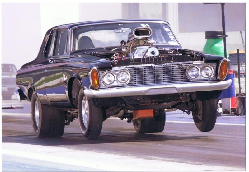

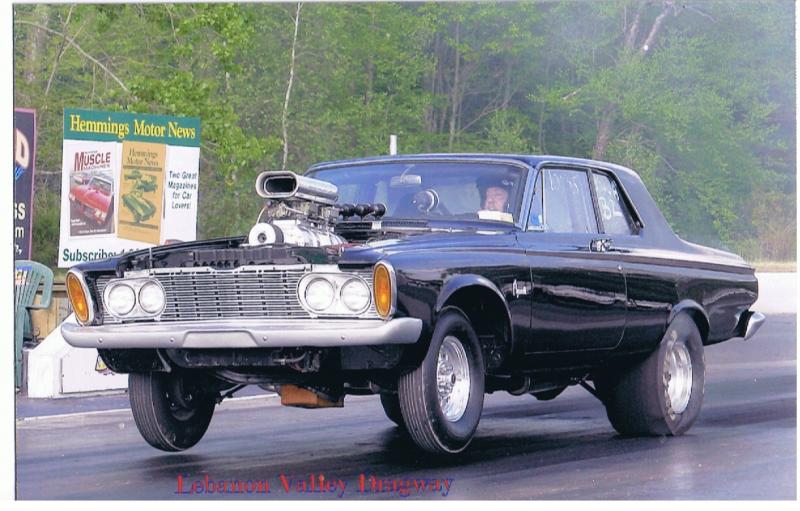

I ran the whole set-up, shocks, mono springs & bars from Calvert/CalTracs for 6+ years, street & strip on my old 68 RR, I didn't do a ton of long trips or lots of commute driving, I had no issues at all ever... I plan on doing the same thing on my current 68 RR HT, when I get some extra cash...

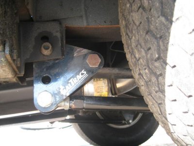

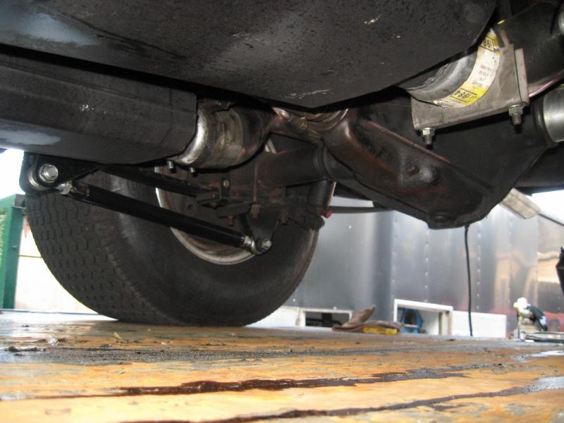

I run them on my Coronet. They are a little choppy on the street unless you back off of the preload on the bars.
yep
:iamwithstupid: back of the pre-load slightly they won't clunk so much, if you put a piece of rubber hose above the pivot bushing to keep the clunking noise down some on the street, just remove it & readjust the pre-load for track use...
I just soften the shock adjustment for the street:blob1:
