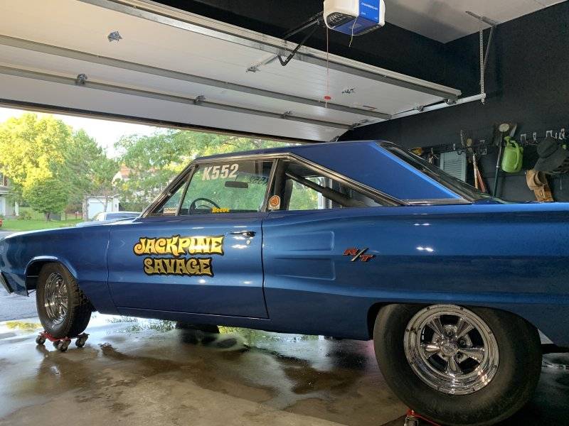

Beautiful car! We moved the axel back on my 67 R/T running 29x9 Hoosiers also. My spring kit has two sets of holes hoping the back ones work for that.

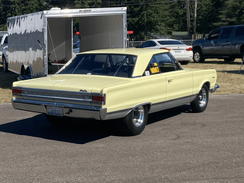

On my 66 Belvedere I have 9/30/15 slicks on it to roll around they fit with no problem, maybe it’s the width where you guys are moving the rear back?

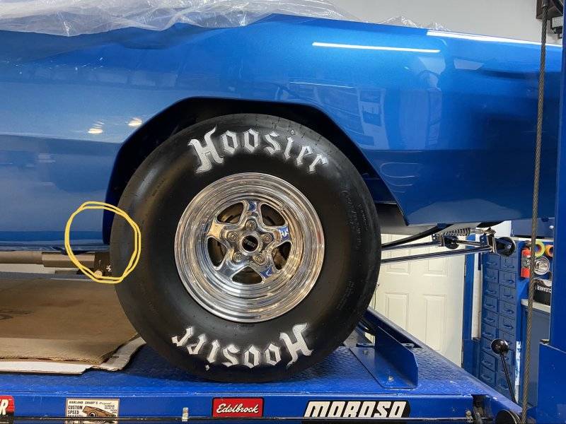

I think that the tire gets real close to the back of the rocker on those. A friend sent me some pictures of his buddy who raced a beautiful 67 a few years back. Apparently the tire grew on the big end and it ended up catching the rear of the rocker. Tire blew, car destroyed and his pal ended up very hurt. For myself, I make sure to have at least 1” of room. But hey, Merry Christmas everyone!

My R/T rubbed on the passenger front wheel opening when we switched from 28” to 29”x9” Hoosiers. Rolling it was ok but at the track it put a groove in the slick.
This was too close for my liking. It was just under an inch on the driver’s side. Went to a shorter tire.
