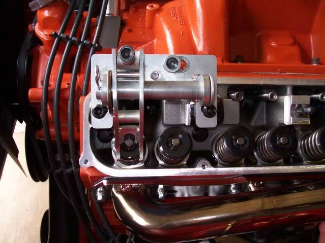

This tool I bought from Mancini racing made the job much easier as you run the allen head screw down to push the valve spring down. And then you can use both hands to remove the retainer and keepers. All the others I use you have to keep one hand on the lever bar and only get to use one hand to do it. Dont remember what I paid but its worth every penny. Ron
Very neat valve spring tool Ron.
what do you use to stop the valve from falling in the cylinder?
Remember though, if air is all you use to keep the valve from falling, at least run that cylinder's piston up to TDC in case the valve falls anyway. It will keep it from disappearing. Although the seal would probably hold it.....it pays to be safe.
Another old trick to keep valves from falling is to shove a section of small dia rope in through the plug hole, filling it up. Just leave a tail hanging out so you can retrieve it when your finished....
