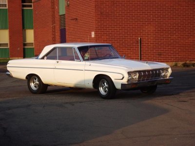

Ok, So I have my 64 Belvy with a 400 in it. It was rebuilt before I bought it with flat tops, crower cam, stock heads and a DP4B intake with an edelbrock performer 750 on it. A couple of years ago I put in a comp XE with 274/286, Lift .488/.491. It pulls pretty good but doesn't have the idle I want. I got spoiled with my 340 with the 274/474 purple shaft. I want more attitude with similar performace. Does anyone have experience with either of the following:
Comp Thumper 279/296, Lift .486/.473 107 degree centerline
Hughes Whiplash .518/.518 229°/242° 197 degree Center line.
Car gets street driven regularly, Not raced(yet) 2500 Stall 727 Stage 2 Shift kit, 3.55 sure grip. Car now has manifolds instead of headers. Headers were a headache.
