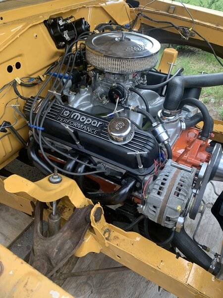

An aluminum water pump housing from 440source vita has rap on a small sized port inside the housing. I have not had any issues with mine. It is also easy to open it up with a die grinder or even a dremel. So have no worry there. A aluminum W/P and housing takes care of the front of the engine. The only other thing is aluminum pulley, which I wouldn’t bother doing, unless it didn’t have any AND a stock look isn’t needed/wanted.
Your call.
