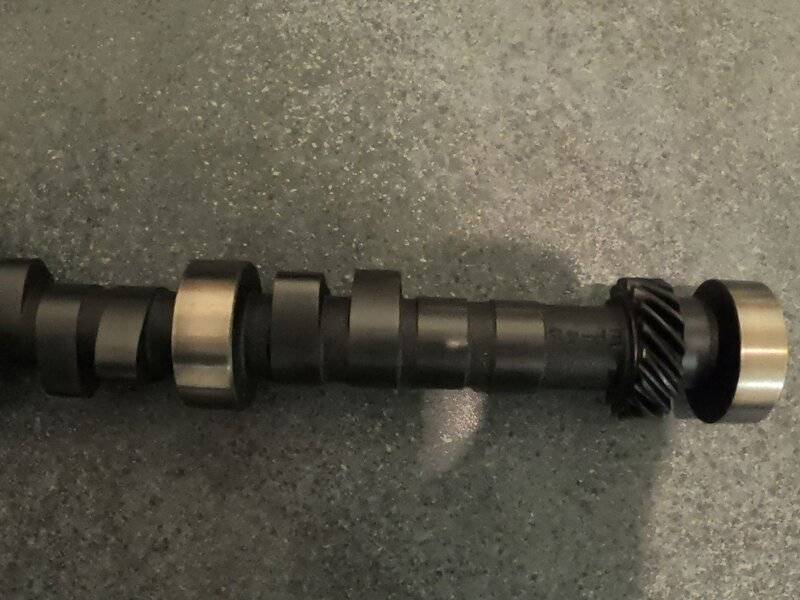

Can you tell if a cam has had the nitride treatment by looking at it.
My cam card says it has been done but there was some confusion from Summit Racing where I ordered it as to weather it had been done or not. I wasn't charged for the service.

I’m gonna say no it’s not. Look how smooth mine is between the lobes. They do extra work on the nitrided cams.

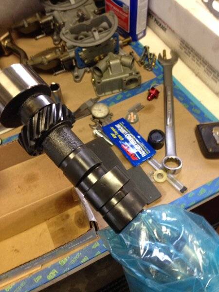

I've got one at my shop right now, tomorrow I'll take a look but I don't believe it is machined like yours...
