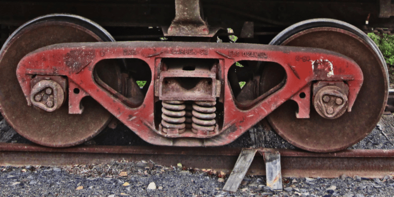

As experienced by working on the railroad, I can attest that these major castings are cast steel, not cast iron. Easily torch cut and welded on, too.
