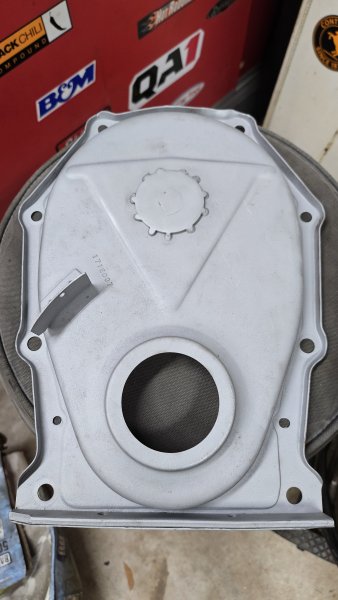

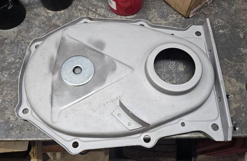

The cam button contacts the timing chain cover, so you should really add extra support to be sure it doesn't flex. Some guys may say that is not needed, but I would rather be SURE it doesn't flex. Here is a recent one I did by simply welding a washer to the cover. Don't go crazy with thickness, as there still needs to be room for your water pump housing!
Good luck!
As mentioned, test the waterpump fitment and clearance after the endplay is set and cover fully installed. I have done slight grinding on back of w/p to just barely touch. Gives it some strength
