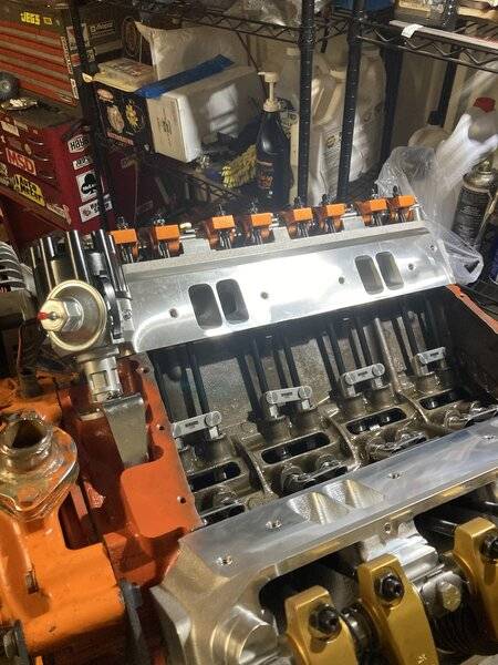

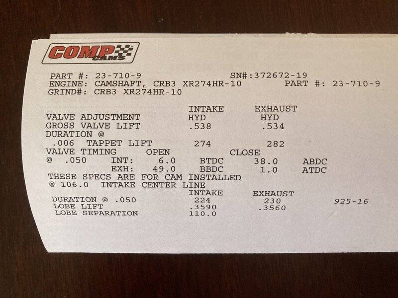

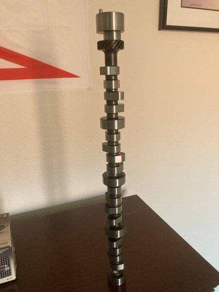

Agree with everything said above, just finished my 440 build not too long ago. Very similar setup: stock stroke, .030 overbore, using ICON flat top forged pistons making 10.5:1 CR, Trick Flow 240s, Edelbrock Performer 440 intake, 930 CFM Holley double pumper, 1.6 Harland Sharp rockers.
My bumpstick is the Comp XR274HR. Makes terrific vacuum and great power up to 5800 RPM. Idle sounds amazing. I would highly recommend this cam.
I would also agree with the statements above about aftermarket heads. For the cost of fixing your old ones, you can afford new aluminum performance heads that flow WAY more and weigh a lot less than the iron heads. You won't regret it, trust me.
Haven't even had it on the dyno yet but I can estimate I am making at least 550 HP and ~600 lb/ft torque on a basic carb tune.
