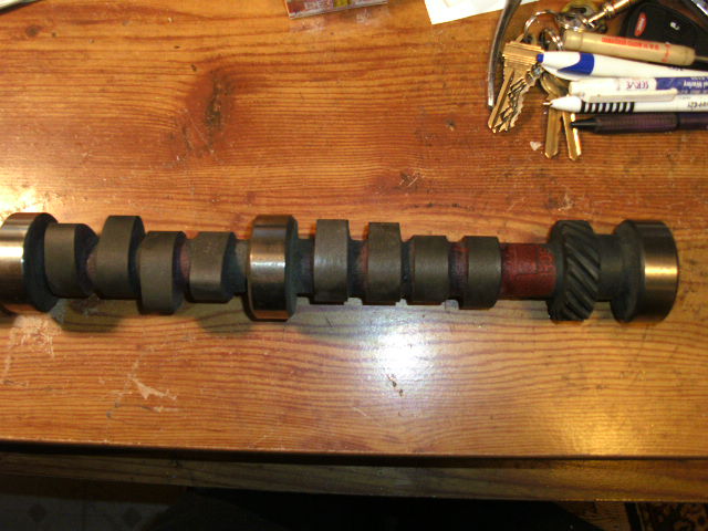

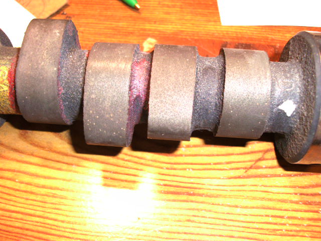

Bought this camshaft with some other mopar stuff, and would like to know if anyone can tell me who manufactured it, is it radical or a decent street cam or for racing only? It is brans new but this is all that i could get off of box. no brand name.Thanks
It looks mild to me,..................very,very mild.... .442/.465 is not much lift and the 280 and 290 are the duration numbers.
Basically just good for burning off the tires, and not worth a crap after that. Thanks for the info.
