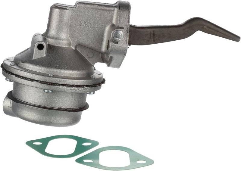

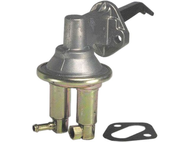

KD. Put up a pic of what you are calling a “stock pump”.
Yes. I have seen over 10# from a stock mechanical pump.
The maximum pressure that can be developed is limited to the diaphragm area and the spring pressure that pushes on the diaphragm. The push rod or lever arm operates the diaphragm via the spring. The pump is a positive displacement design. At ZERO FLOW pressure will maximum, limited by the pressure spring...the pump's volume is detetmined by the diaphragm area. Its not quite a linear relationship between pressure and volume.

To remind, this is a stock appearing pump in a 360. I'm going out back in a few minutes and will have more info soon.
Does it look like this:
Or this:
