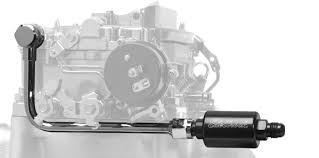

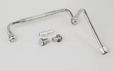

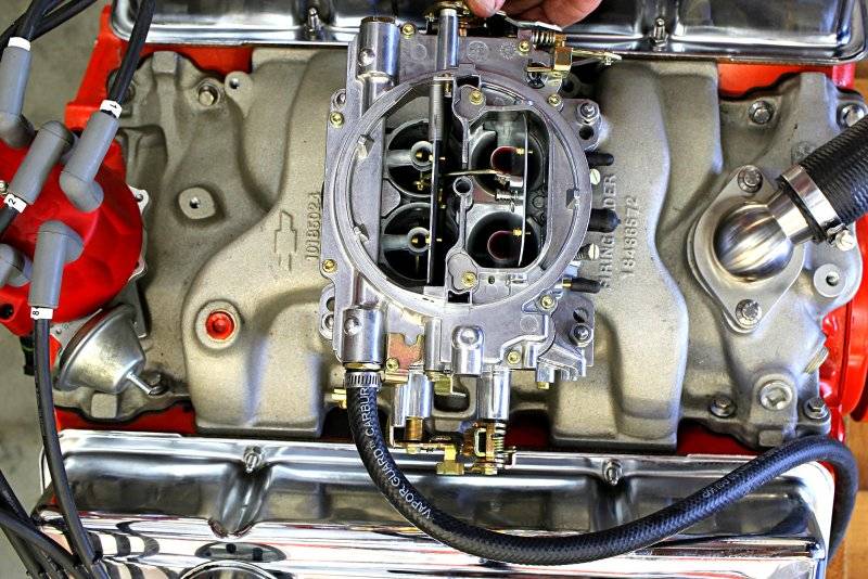

One idea is to use Edelbrock's fuel log shown here, but I'm not that familiar with their banjo fittings. Can I connect the regulator on the end of the driver side portion of that fuel log? If I do, then I need to do a 180 with the return line to connect back to the current return line that runs down the passenger side - OR I can run the new 3/8" return line down the driver side, diving under the steering column I guess?

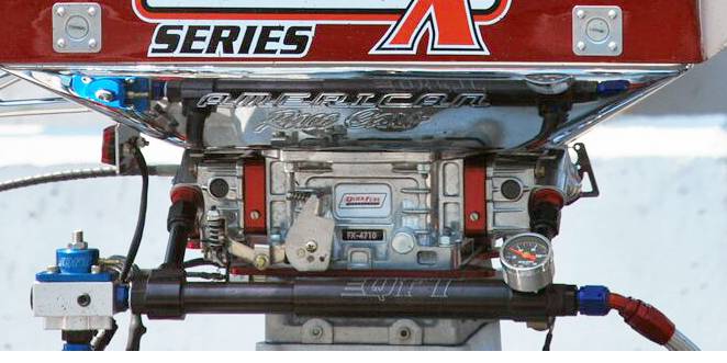

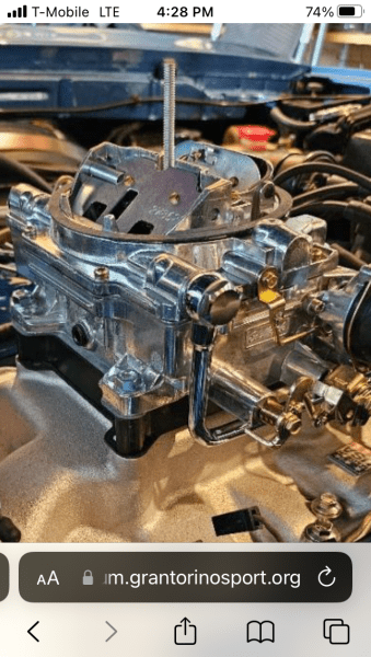

I wish i could find a fuel rail that will fit the AVS2 with a tee- port in the middle between the banjo fittings to connect the regulator to, so as not to disrupt the carb fuel supply. Or if I just connect the regulator off the passenger side banjo fitting does it accomplish pressure regulation without being before the carb sees fuel (at least at the same time the carb sees fuel)? Example AVS2 with banjo fitting below.
I might be overthinking this. What if I just install a nipple at the passenger side banjo fitting end and connect the fuel regulator to that? Then it’s not before the carb sees fuel and still reading overall carb pressure.

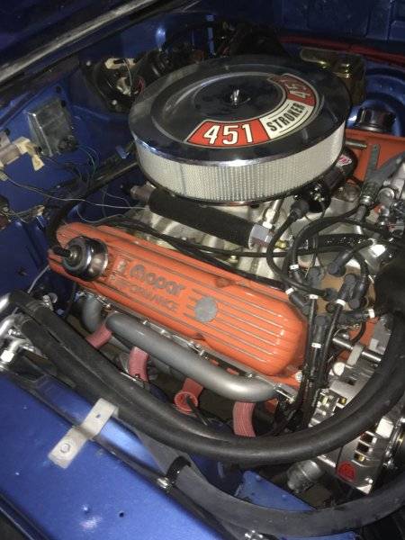

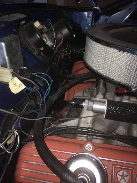

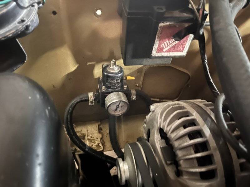

This may not be the cleanest or the best setup , I’ll probably be changing it eventually, but it works . Hardline from the tank , to its factory end spot, rubber line to the pressure regulator in the inner fender, which I don’t know if you are using a high pressure electric fuel pump or not but the edelbrock 174053 isn’t bad, I’ve had it in use for 5+ years , and then rubber line to an aluminum line up the block like factory, to another rubber line , to an edelbrock 8126. Again probably too many connections and rubber lines , but it hasn’t let me down. Here’s the best pictures I could take
thanks, but I'm trying to keep the regulator AFTER the carb, not before it. I'm running a carter mechanical pump that supposedly puts out around 8-10 psi (never measured), not an electric one.

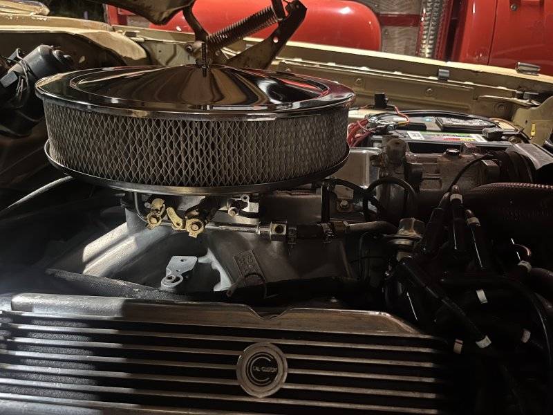

I run a mechanical fuel pump on my 432 Stroker
800 AVS2
7 PSI
Factory 5/16 fuel line
No return line
Factory AVS fuel line to carb
Carter .110 Needle and seats changed over from Edelbrock
3/8 Float Settings
91 or 93 Octane with 10% Ethanol
Never experienced vapor lock ever on hot summer days in six summers
Supports a 500 HP 383 / 432 on the street
Great Street Carb , to a point
